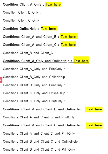

Hi, I'm struggling to understand the logic of condition expressions and I have a hard time defining the expression that meets my needs.
I have three client tags : Client A, Client B, Client C.
I have two output tags : Online and Print
Text can be tagged with multiple tags, since some functions are common to Client A and B, or Client A and C, or Client B and C.
Furthermore, in my help topics, I have links to help pages that are specific to one client and that are tagged with Online and Client A, or Online and Client B, etc. And I have links that are common to all clients that are tagged only with Online (since I don't want them in a printed output).
When I produce my online help for Client A, I want to see text that is tagged with :
  • Client A
  • Client A and Client B
  • Client A and Client C
  • Online
  • Client A and Online
  • Client A and Client B and Online
  • Client A and Client C and Online
I have successfully built a condition expression that includes all the text tagged Client A, whether alone or in combination with another Clients tag or with the Online tag, and excluded any text tagged with Print. Which is almost what I want.
However, I can't find a way to include also text that is tagged with Online only. Is it possible ? If yes, how ?
Here is the condition that I have written so far.

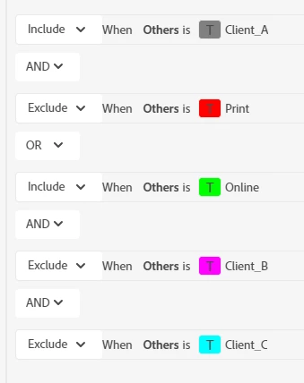

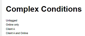

    March 1, 2024
    Wow...
    This expression:
    produces this:
    If I switch the order of the groupings:
    it produces this:
    This is the required output I believe.

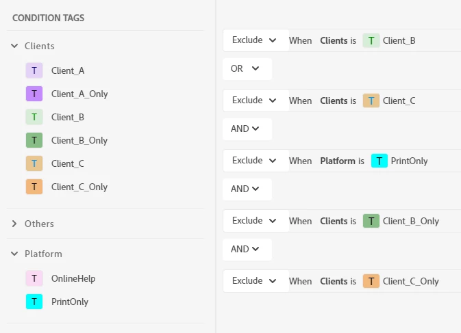

    I finally got it !
    @Peter Grainge Your reminder finally triggered illumination 🙂 :
    "The key thing to remember is
    • With AND expressions any content that has any one of the tags will get excluded.
    • With OR expressions all the tags in the expression have to on the content."
    Below is the condition expression that I ended with (after creating the additional tags Client_A_Only, Client_B_Only, as you suggested, and retagging my text with those tags), which works when I generate my online help for Client A and that I can easily transpose to Client B and it also works !!!
    And here is the result, which is exactly what I want.
    Thank you very much again @Peter Grainge and @Amebr !!!
