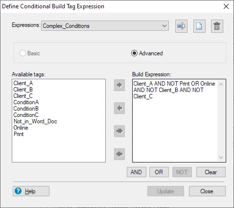

    Nov 16, 2022 3:43 AM UTC
    I can't do what you want in New UI, but I can in Classic. 😕😕

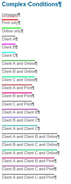

    Firstly I set up a Classic project to figure out how to do it in the product I'm familiar with. I set up a topic with paragraphs tagged with multiple combinations of Client A-C and Online and Print.
    The I wrote a build expression using the Advanced interface:

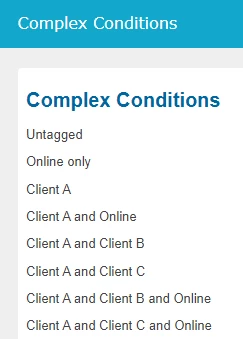

    Which I think meets your requirements of adding "stuff" tagged with online only.
    That took me about 2min to set up in Classic.

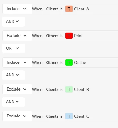

    But replicating that expression as best I can tell in New UI
    Results in this:
    I've tried about a billion combinations of AND and OR and I can't figure out exactly what it's doing.
    For simple cases, Classic and New UI appear to be doing the same thing.
    For example "NOT Client_B AND NOT Print" and "Exclude Client_B AND Exclude Print" produce the same thing - it excludes anything tagged with either Client B or Print.
    Switching to OR also produces the same result in both version - it excludes anything tagged with BOTH Client B and Print.
    But getting into the more complex equation with both AND and OR, New UI appears to be doing something different from Classic, but I haven't been able to figure out what.
