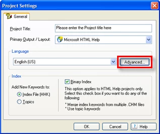

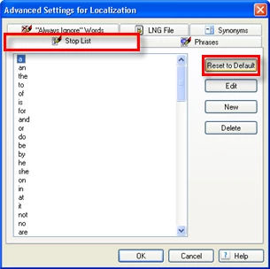

To reset the Stop List:
  1. Click File > Project Settings...
  2. Click the Advanced button.
  3. Click the Stop List tab and then the Reset to Default button.
Cheers... Rick
