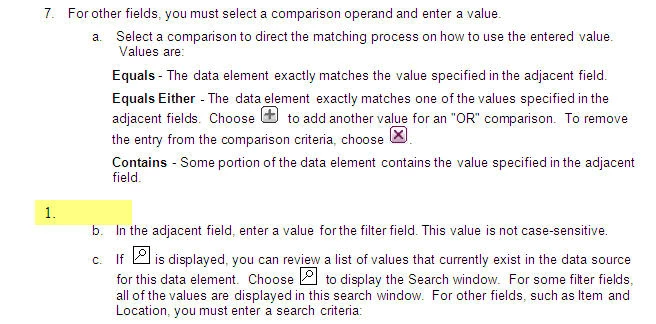

In our RoboHelp 8 project, we have in some places a problem in the DOCX output (Word) with nested lists. The second level is interrupted with a blank first level number, before it continues with the rest of the second level list. Note the highlighted "1.".  This was not intended.  I checked the HTML, and the code is the same here in other similar places that output correctly. Is this issue similar to the issue in this thread?  (Or should I post my question elsewhere?)  This project is very large, so it would be nice to not have to scroll through 1000 pages in the DOCX to specifically find this problem to correct.

March 18, 2010
Right thread but no easy answer. Lists are just a nightmare when it comes to exporting to Word. There's a topic on my site and whilst it may be old, nothing has changed. Good luck.
