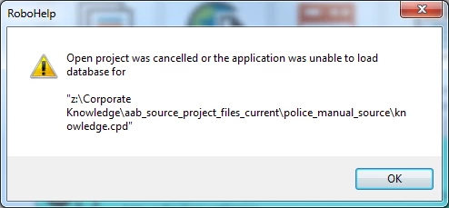

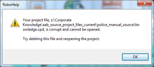

I get the following errors when I try to open a new project after the .cpd file has been deleted:
A new .cpd file is created and is about 836Kb in size. The project runs through its start up but hangs at the 'ready' stage. If I then try to reopen another project everything opens, but the ToC is missing and all other links are broken. If I then close this down, reinsert the massive .cpd file it loads ok and rebuilds the project, but is still very sluggish.

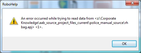

I followed your advice and still nothing. I've also had error messages with the rhbag.apj file (images below). This morning I came in and the search function is now not working and the following error message is present "Failed to initialize database".
The rhbag file issues:
I've also had a similar message with a <5> to end it. I have read forum replies about similar problems asking for the rhbag file to be opened and to check the HTML, but I'm not an expert there and it all looks the same to me!
Once again, help would be very welcome.
Phill
May 26, 2017 5:42 AM UTC
Is Z: a network drive? RH performance is highly dependent on network performance, so some of your issues could be related to your network.
If you have one, use a copy of the project from before you started messing around with the cpd.
Try putting a copy on your c: drive, preferably a short path like c:\temp.
Does it open quicker?
Try deleting the cpd and re-opening. Does it work this time?
