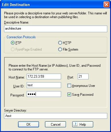

Hi for All,
In a server (RedHat Linux 5) and installed an Apache 2.2.16 within the folder 'htdocs' created another folder called 'architecture'. From RoboHelp 8.02 performing a Browser Based Help and publication in the 'server' I am setting the following configuration:
Descriptive Name: architecture
Connection Protocols: HTTP
Host Name: http://172.23.3.59:7777
Server Directory: / architecture
However, when I click 'Publish' application to work. What could be wrong? How can I do to publish my project?

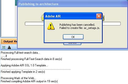

    Hello, Thank you for your reply. However, I'm still with the problem. Yes,  I have tried to generate a WebHelp and ran from SSL and it worked, but  when I try to FTP publishing the message "canceled by user" appears. Of course, it is important to emphasize that I have permission to write to FTP with the user I'm telling. I  tried to copy the content that is on the way "!SSL! \ Adobe_AIR \  BrowserBasedHelp" directly to Apache, but this did not work.

    Additionally, follow the images below error occurring when I use the FTP publishing.
