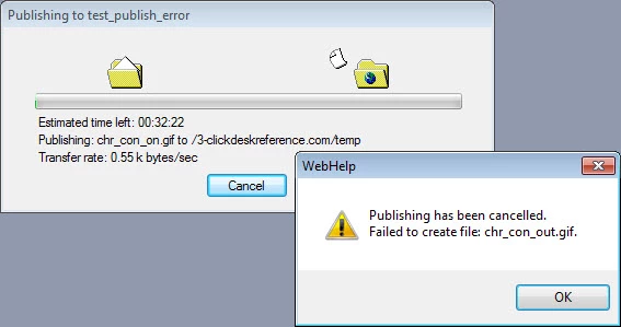

I created a test project (as WebHelp). It generated correctly but again failed during Publish at the same file (chr_con_out.gif) that causes all of my other projects to fail. The .gif file is present in all of my projects and is part of the standard Chrisi skin. Here is a screenshot of the error:

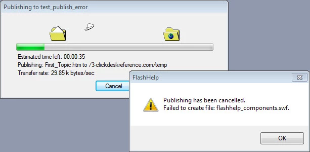

I generated the same test project as FlashHelp. It generated correctly but failed during Publish. I don't use FlashHelp, so I don't know how to interpret the error. Here is a screenshot of the error:
There were no errors to indicate a problem with the FTP connection.
