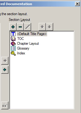

My print document section layout looks like the following screenshot. Any ideas?
V.
