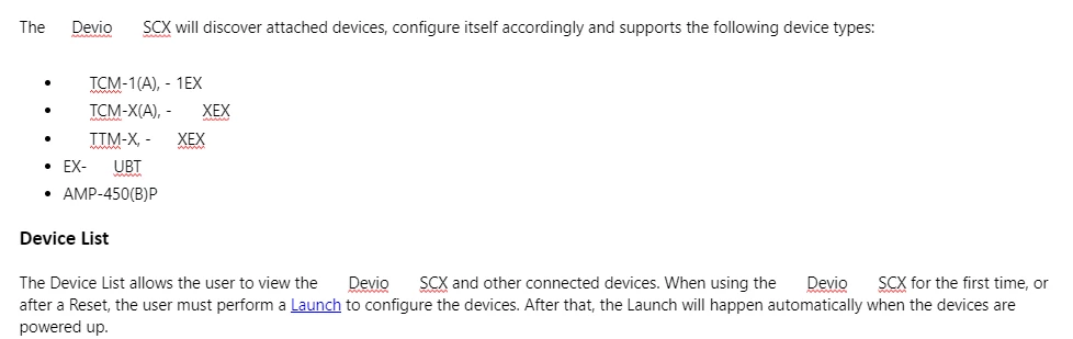

Random spaces throughout Robohelp 2019
I am new at using 2019 UI. I have random spaces throughout my copy. I notice in the html at the top of the page that <span> appears in the words that are spaced apart. I'm also finding that many of my bullet lists don't line up. This is happening everywhere. I find myself dealing with issues like this instead of actually getting my work done. How to I fix this?

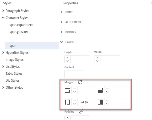

Delete the 24 px from the field and then save the stylesheet and you should be fine.

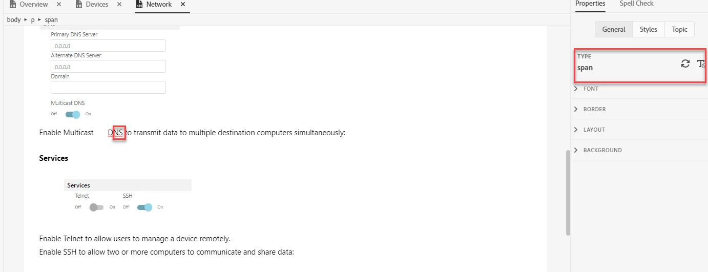

The message about the alt text on images won't stop the images displaying - it's best practice, but not actually mandatory as far as I'm aware. I think it would be best to make a separate post for the image problems, to avoid confusion in this thread.

Yes I saw Amber had fixed it. As she said, the Alt attribute is something you should do for accessibility reasons but it is not enforced and will have had no bearing on this problem.

AmebrCommunity ExpertCorrect answer
Feb 1, 2021 12:42 PM UTC

Feb 1, 2021 1:18 PM UTC
Hi Amebr,
Deleting the 24 px fixed the problem.
Thank you so much!!!

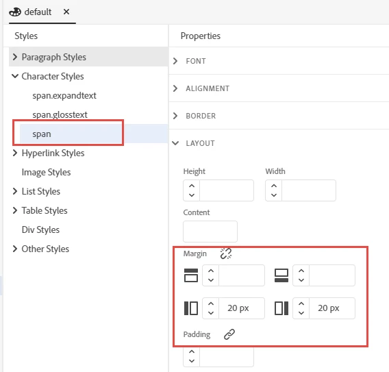

Feb 1, 2021 12:32 PM UTC
Hi Peter,
I'm looking at span and it looks like it has a left margin of 24. Could this be the problem? If so, what should I do?
I just found another problem. When looking at the code view I'm seeing:
This must be why a bunch of my images don't show up on my output. Do you know what I should do to fix this? I created a webhelp in the Classic view a couple of months ago and didn't have any of these problems.

Look in your stylesheet under "Character Styles" for an entry that is just "span", then check in Layout for Margin or Padding values.
Feb 1, 2021 12:07 PM UTC
Hi Amebr,
I found the span as you said. What do I do now? Do I get rid of it? Then Save? Do I have to go through the whole project and remove the margin?
Feb 1, 2021 2:58 AM UTC
Hi Peter,
I went through the whole project and Cleared the Formatting and it looked like it worked. Then I saved and closed the project and opened it and it was back to where it was. I have no idea how this happened or why. Nothing had a justified alignment. I have to get this whole web help done by Thursday and I don't know how I'm going to make it. This problem is througout the whole project. I had none of these problems in the Classic view. I'm at my wits end.
Feb 1, 2021 2:30 AM UTC
I'm wondering if you somehow have a span style configured with either margin or padding?
Look for a plain span entry without anything after it, and check the margin and padding values for it.
(Don't change the span.expandtext or span.glosstext entries, you just want to find a plain span, if it exists.)
Feb 1, 2021 3:03 AM UTC
Hi Amber,
Thanks for your reply. I'm not sure what you mean by "look for a plain span entry"? Where do I look and how can I check the margins and padding? The image below is what I'm seeing.

Peter Grainge
Jan 31, 2021 6:02 PM UTC
That looks like the alignment is set to justified. Click in one paragraph and then look in Properties > General > Aligment. It may have been applied manually in which case click the Clear Formatting icon in Properties.
