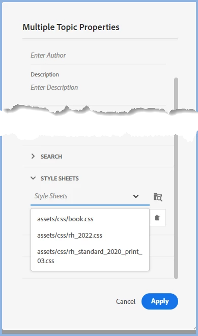

    I'm not sure if this helps, but if you go in to the Topic List report, select a bunch of topics then right-click and select Properties, the Stylesheets section will show stylesheets that are common to all the selected topics. You should then be able to delete from all at once.
    Do note that it only shows stylesheets that have been applied to ALL the topics selected though.

    Thanks for the note! Otherwise, I would have assumed they were all correct already. And it worked perfectly in RH2020.
    "Do note that it only shows stylesheets that have been applied to ALL the topics selected though."

    You could also select all the topics in a folder, right click and select Properties. That will show you topics with multiple CSS and you can delete from there.
    Only one CSS will be shown initially but the down arrowhead lets you change that. Then you can delete.
