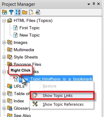

Have you tried right-clicking one of the broken links and choosing to Show Topic Links?
Perhaps that's worth trying.
Cheers... Rick

Thank you, Rick for your prompt answer. I have a few questions for you. First of all below is a screen capture of my Project Manager window showing the broken link
Notice that in your screen capture the broken link says "New Topic.htm#here is a bookmark", while in my screen capture it does not identify my Broken Link as a bookmark. Also, I used RoboScreenCapture to get my screen capture and I don't see all the fancy stuff that you were able to do in your screen capture. Are you using a different Screen Capture program?

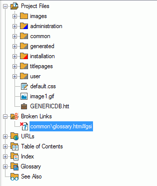

Meanwhile, I can right click the broken link and do "Show Topic Links" and the link view window it produces is seen below
Which seems to imply that there are no links to the bookmark. Again, my question is if there are no links to a Broken Link, why is it a Broken Link?

I use TechSmith SnagIt for my screen capture program. A wee bit "fancier" than RoboScreenCapture.
Your link seems to imply a bookmark named gsi? Noting the #gsi in the naming.
Wondering what happens if you just open your glossary.htm file and add a bookmark named gsi somewhere in the topic.

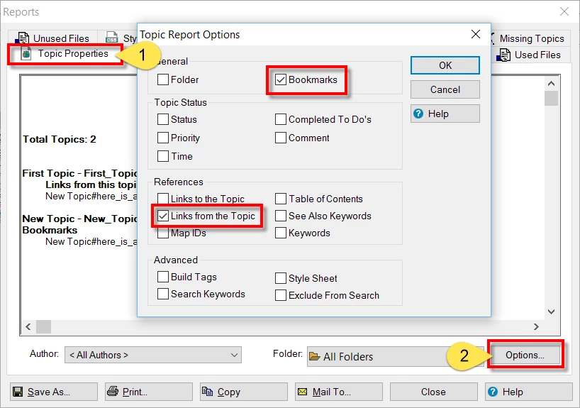

Then use Tools > Reports and look at the Topic Properties report configured to filter as shown below:
