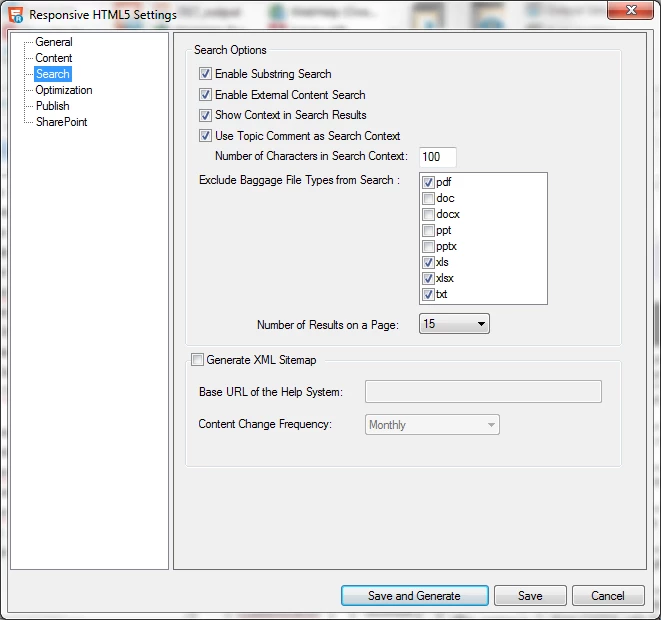

Everything's toggled on in the search setup:
