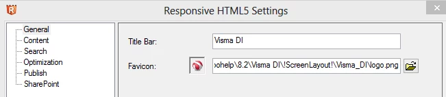

Responsive HTML ignores favicon setting
I use Robohelp 11, and have set a favicon on the project using a Responsive HTML5 layout:
But when I generate the project the favicon is not added to the finished HTML-files so no icon is shown in the browser tabs:
If I add the same image to a WebHelp Pro project and generate, the favicon is added to the HTML-files.
Does anyone have any suggestions as to how I might correct this?

Using RH 11, and when adding the icon via the Responsive HTML5 Settings (as per the original idea) works for me, but only for the root, 'index' topic. Basically, if I have created a 'book' with a TOC, and I browse to any topic except the 'first' topic, the favicon is not visible - it's only visible on that 'first' topic. Looking bug-like to me too.
Jun 3, 2016 4:32 PM UTC
I see the status of this is Assumed Answered. It seems that a bug still needs to be fixed. So this seems a mis-classification.Yes, we can insert code, but there's a Favicon entry box in the UI that does not work.
Enough grumbling. If I have a merged help system with a parent redirect, does the icon code string go in the parent redirect file or in the file that it redirects to?
