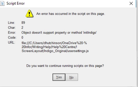

I'm struggling with this too. I like the Indigo layout, and have made some modifications that make it look more like I would like. However, it's very buggy, for example when I run a preview I get a javascript error "object doesnt support object initindigo" in usersettings.js, so there are bugs in the javascript.

It's looking like something got horribly messed up in your customisation so the first thing to do would be to import the layout again giving it a new name, say Indigo2. That will not overwrite your customised version so you can go back to that later.
Also I see you are using OneDrive. That is OK but it can create long path names that will fail.
What I would do now is export your customised layout and import it into a simple new project with just two or three freshly created topics,.Create that project outside of OneDrive in something like C:\Test. After importing your layout, import a new copy of Indigo from the gallery, as above.
Now test both.
I think the repeat issues are related to your customisation but testing a fresh project will establish that.
Come back when you have tested as above.
