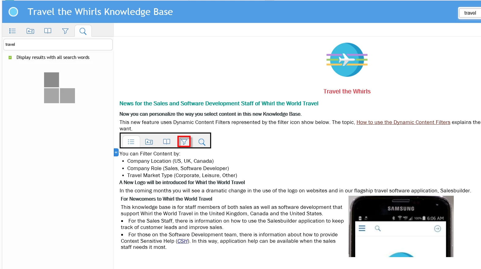

Hello again guys. I feel like I've been submitting a lot of bug defects lately. I found another problem in Robohelp 2017 Update 2 that seems really obvious, so much so that I'm wondering if it isn't something on my end. Could someone else test it out and tell me if the problem occurs for them as well? After generating Responsive HTML5 output (after reimporting the layout, as it is completely broken if you don't reimport the layout), the search feature does not work. It just hangs when you try to search. I've tried it in a few projects, including one of the sample projects:
Does this work for anyone else?
Thanks.

I found William's files and at first glance they seem to fix this issue. I haven't tested it thoroughly, but it looks promising.
I have cross referenced your bug report with Willam's. Please add a comment to https://tracker.adobe.com/#/view/RH-960 and your report when you have tested further.
