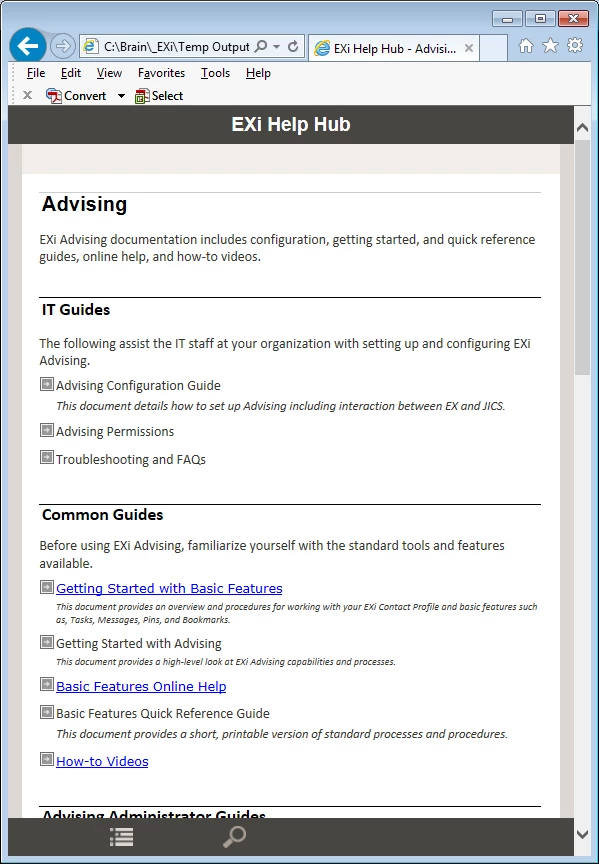

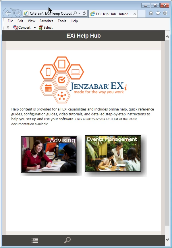

This is how I want it to look when the user clicks the main help icon:
They click on Advising or Events Management and get a list of all the documentation available:
The two topics above are in my Parent project: EXi Help Hub

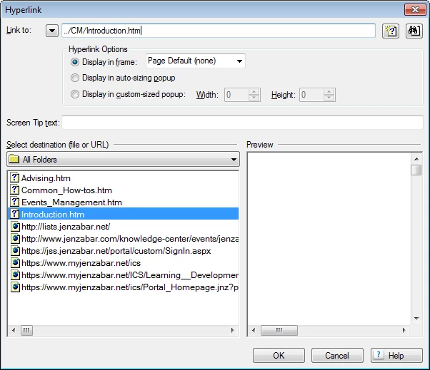

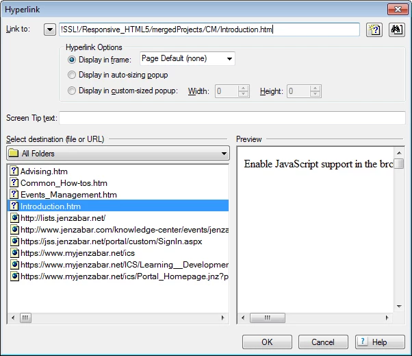

I created the link to the child project by highlighting Basic Features Online Help, right-clicking, and selecting add a hyperlink, then using the file browser,
Browsed to the child project (CM) and selected its start page and default topic, which is also Introduction.htm (similar to your example above only we use just introduction as opposed to index, but if changing the name to index will remedy the issue, I'll do it in a heartbeat))
After compiling it didn't make the path relative. So I updated it to .../CM/Introduction.htm
Still didn't work...
What am I missing? Is there a better way to accomplish this? We'll need separate projects for each software component and our product is being designed for responsive design so the help needs to be as well. Part of the reason we went with the RH11 upgrade.

Ah, I think I see the problem. I thought you wanted to go from the child to the master, but you need to go from the master to the child.
In that case, the link in the master should be: mergedProjects/CM/Introduction.htm (if the topic is in the root of the master project.)
Only if you go from the child to the master, the link in the child should be: ../../Index.htm
