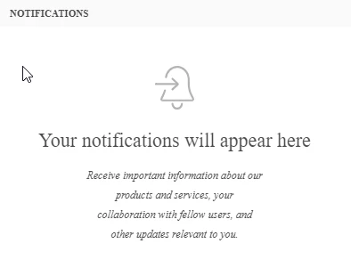

Hi, my team and I are using the Robohelp (2022.4.179) review functionality to review a number of topics within one of our help systems. Is there an easier way to see which topics have comments other than opening every single one individually and checking? I see when I open the review online there's a notifications tab. However, it always claims my notifications will appear there and they do not. I get notifications in the Creative Cloud that someone has commented, but clicking the link seems to open a web version with an unhelpful file. I get email notifications as well, but they just open the review if I select "View all comments."

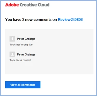

    I am wondering if there is a bug in 2022.4. To answer your question I set up a review from one Adobe account and sent it to another Adobe account. There I commented on just two topics and clicked Submit for each. I then got this notification.
    On clicking the button I got this but to the best of my recollection, it should list the comments. I have asked an Adobe contact to check the process.

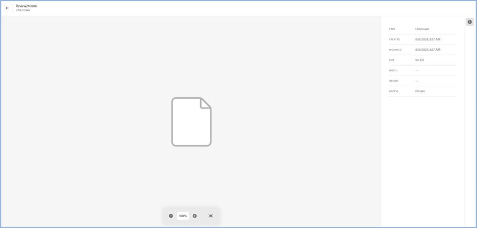

    Thanks! I don't see a way to edit my existing post but here are the images I'd attached.

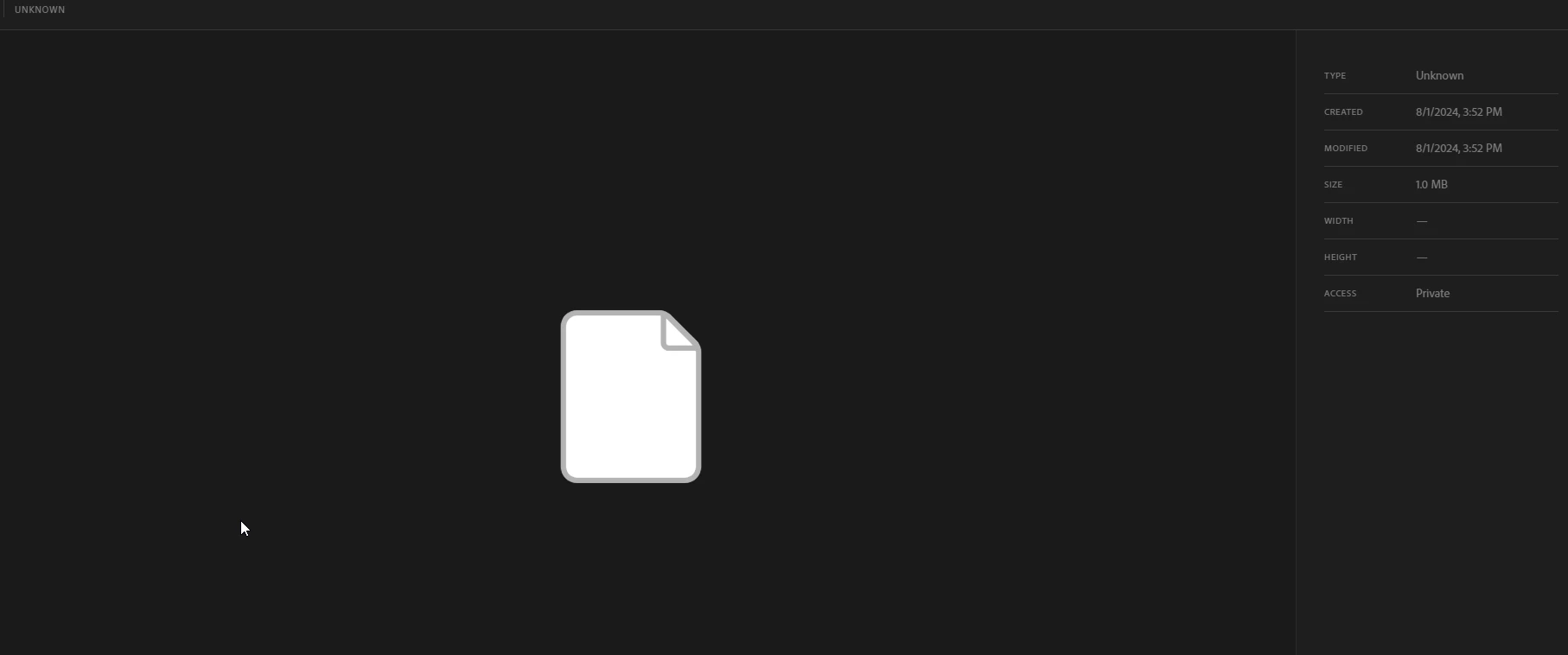

    Above is the notifications in the browser version of the review. Below is what happens when I click on a Creative Cloud notification.
    Asking my reviewers to comment no comment if they think a topic is fine is helpful, but my main issue is finding the comments once they are made. I have 100+ notifications/comments and don't want to miss any. The only workflow I have found to find them is to manually open every single topic in the review regularly. The browser notifications do not appear to be working and the email notifications do not tell me which topic the comments are on, just that they are in the review in general.
