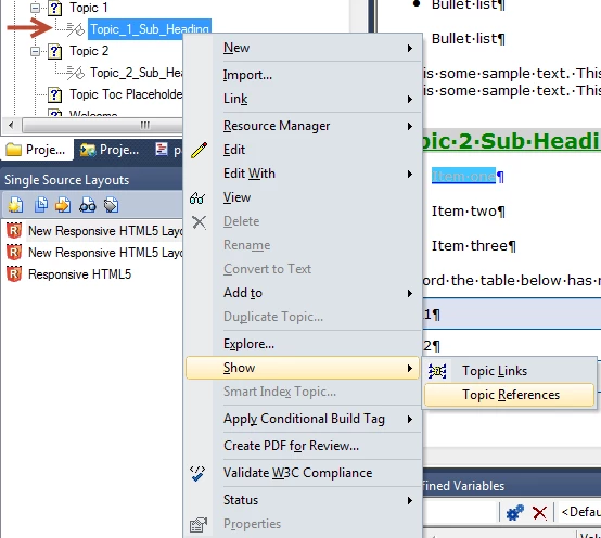

Neither option (Show Topic Links or Show Topic References) does what I need it to do. Even when you right-click on the bookmark, you only get the topic links/references. What I want is an easy to understand Link View or report for every bookmark in the project.

This might not help, but you can see all the topics linked to a specific bookmark by expanding the topic in Project Manager to show the bookmarks, then right-click on a bookmark and select Show > Topic References.

Or possibly Show > Topic Links?
