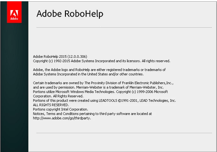

Peter, sorry for the delay.  My co-worker was able to download the and unzip the files from the link you sent.  When he clicked the icon to install the files, which he tried both by clicking "Open" and by clicking "Run as administrator", nothing happened.  If it matters, he is on Windows 10; I'm on Windows 7.  Here is a screen shot of his current RH 2015 "About" window, which shows that the version number did not update.
Any suggestions before we request our IT department try uninstalling and reinstalling his software--and do you think uninstalling/reinstalling the software will work?  He's still going to have to update his software for us both to be on the same version of RH 2015.  Thanks.

Clicking Run as Administrator will only work if you have admin rights.
My suspicion is what rights your colleague has and if that is the problem, they will be able to uninstall but not reinstall. My next step would be to get an IT person to log onto the machine and install the update. If that works it confirms the problem is with rights and IT can fix that as well.
