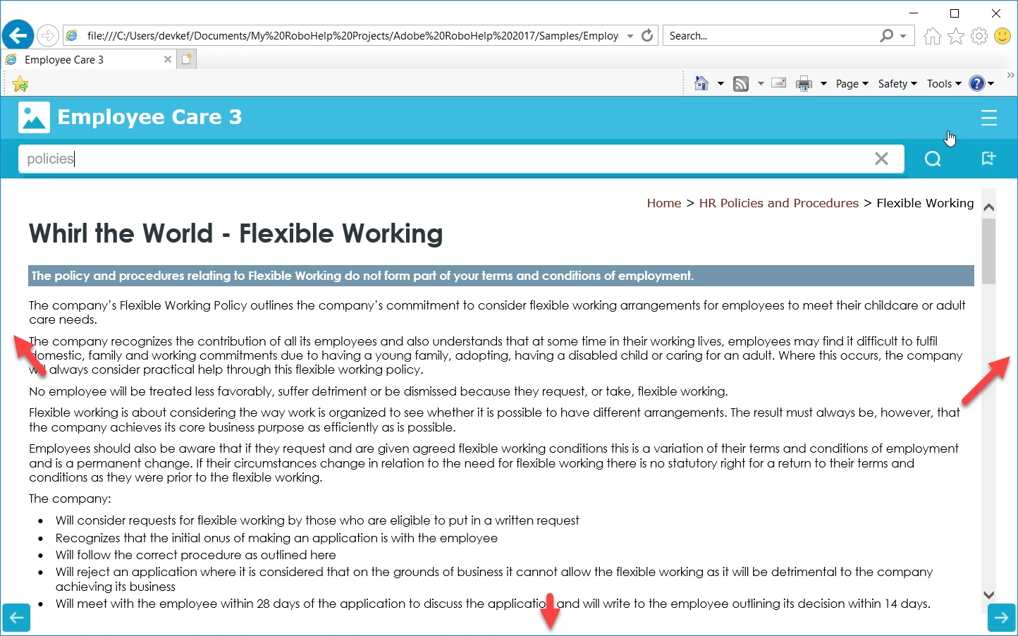

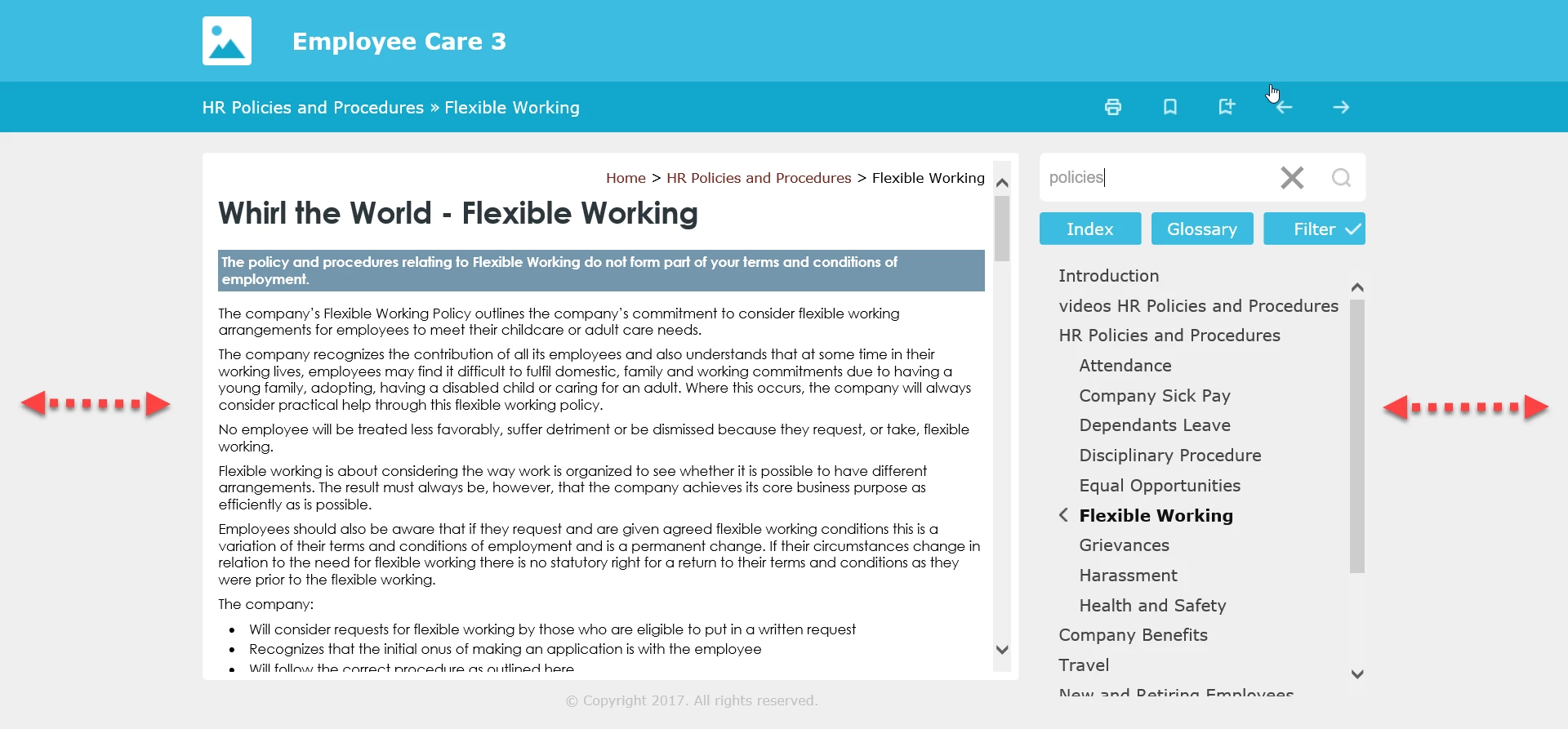

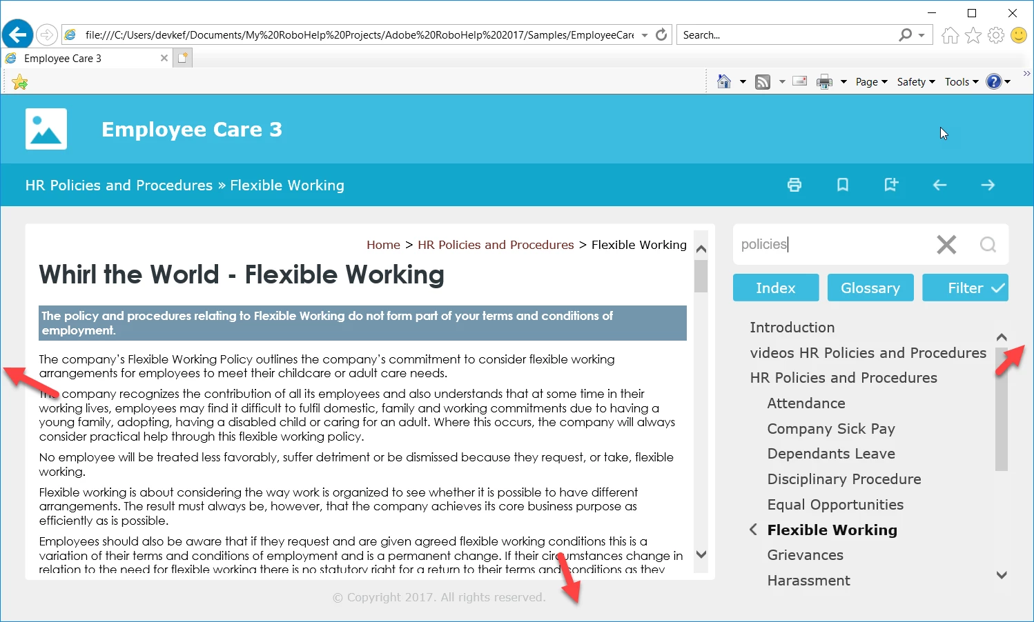

Example blank space using RH sample project, output viewed on larger laptop screen with browser maximized:
Some amount of buffer space shows up as you decrease the browser size, which isn't as disruptive as the space shown in my first image.
Work around once viewing the output is to keep shrinking down browser until it's at a point where renders this layout (topic fills space with limited buffer space visible around topic, search is at top, and tofc is accessible from menu icon).
