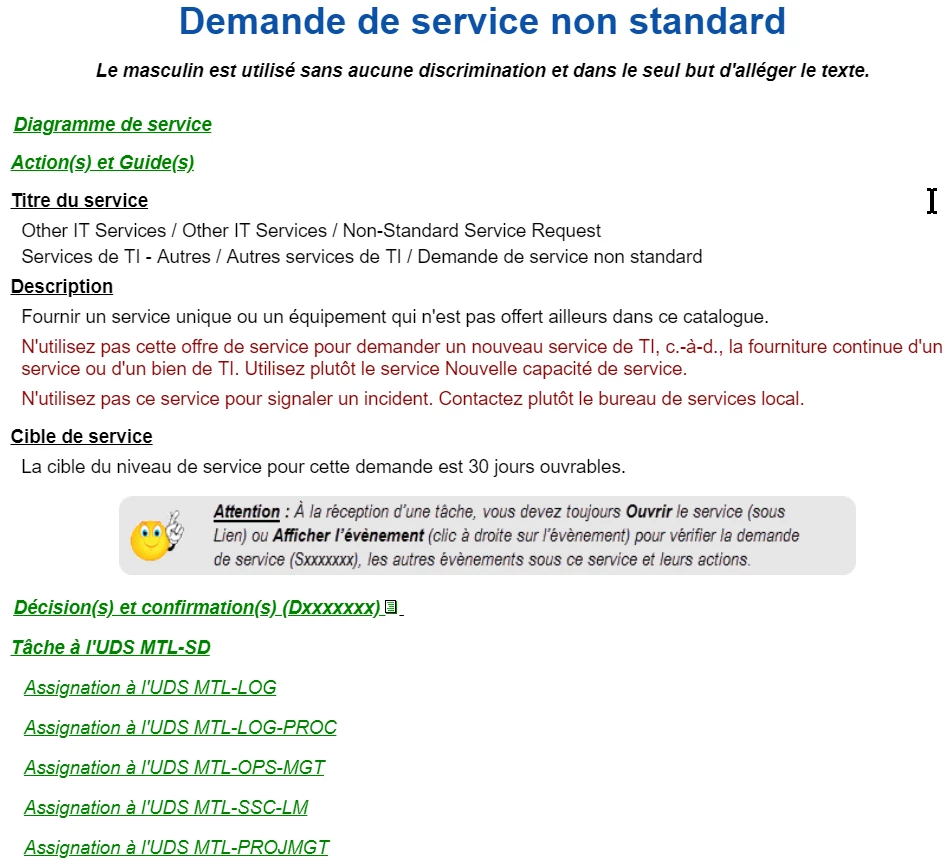

Two weeks ago, there was som updates made on the servers. Since then, we've been having problems with the Drob-down text option. The first image shows the procedure in edit mode and what we also see in preview mode. We can see the drop-down text headers in green.

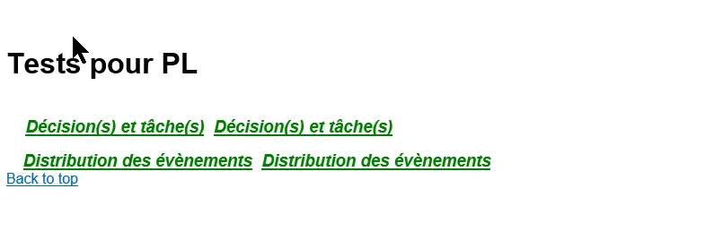

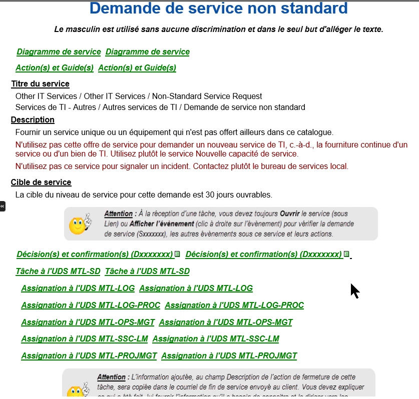

In the second image, you will see the same procedure as seen by our users in web mode;
As you can see, the drop-down text headers our doubled. Also, when we click on them, it brings us at the beggining of the page but the text does not open as it does in the edit and preview modes.
Also, if I create a new topic, the edit and preview will be OK, but Web output will also be doubled.

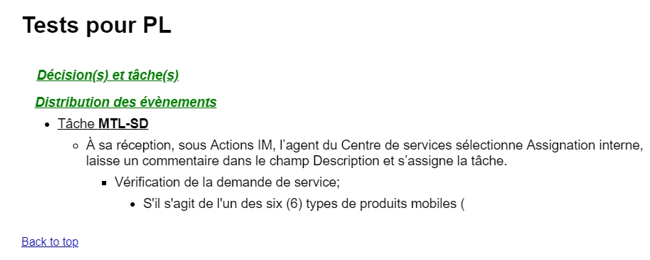

Edit and preview image with a drop-down text expanded.
Web output

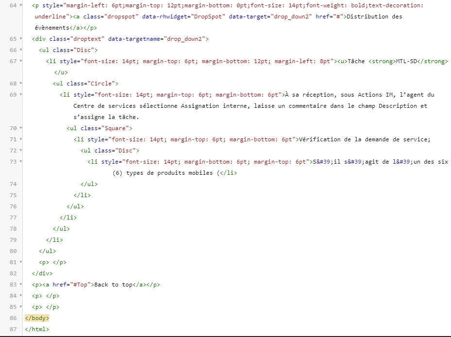

Let's look at the code from line 64 to 82. Do you see something wrong?
If not, when published, why is the Drop-down header doubled and why the text does not drop down?
If the code is OK, then between the topic/code and the publishing, what must be wrong to cause that?
Why is it only the Drop-down (Dropspot) that is affected by whatever is causing this?

Here is the code of the test I did. Maybe you'll see something that is causing this.
