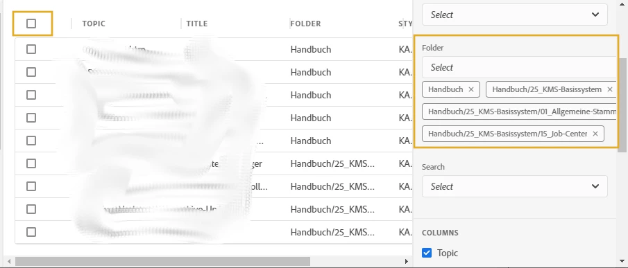

nov. 22, 2019 12:09 PM UTC
Hi Jared,
in the topic list report, on the top left in the header row, before the list of topics starts, there is a checkbox that will select all topics.
Also, you can for example filter for the folders you want to edit and only show the topics in these folders.
Regards
Karin
Traduire
Jared Hess
nov. 22, 2019 1:28 PM UTC
Thanks Karin. I am aware of that check box. I wasn't aware you could select multiple folders like that from the right side. That is indeed helpful, though it is painfully slow still to select multiple folders that way but seems to be faster than trying to scroll to the bottom. I'll give it a try.
Traduire
Jared Hess
nov. 22, 2019 1:48 PM UTC
So I tried this right-pane folder filter with the check box on the top-left some more. There's unfortunately a limitation with all this. That check box on the top left seems to only select the visible list of topics in the window and not all the topics from the filtered folders.
The window only shows a subset of the topics in the selected folders. This is the same limitation as I originally posted.
From what I just tested, you still have to click or press End multiple times to scroll to the bottom of the window to expose all the topics in those folders and then you can use that top-left check box to select them all.
