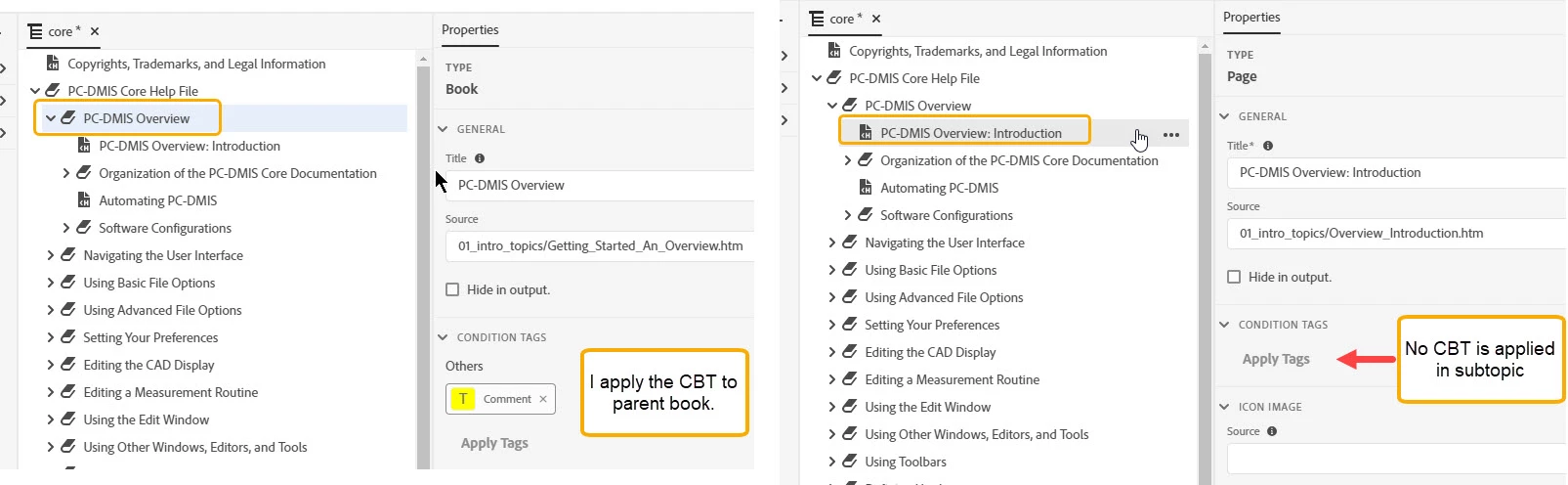

Perhaps, if you were like me, after some head scratching you decided to shift gears and decide to use some kind of "Comment" Conditional Build Tag (CBT) on nearly all the folders and then exclude that CBT from your generated output. If you apply it to the TOC main book entries, it'll affect all the subtopics right? Well I'll give you extra points for creativity there, but remember in RH 2019, applying the CBT to multiple TOC "books" is not possible. You can only do one book at a time and in fact, it it doesn't apply the CBT to any subtopics in the books. It only applies the CBT to that one topic. Nice try, but this is the same as RH 2017 so no blaming RH 2019.
So, thinking outside the box, you think well, I remember seeing a Contents pane in this new UI. How about applying the CBTs there? Ah-hah, good thinking! Indeed you can do that... but again, there's another challenge. You can only apply the CBT on the topics inside the folders and not on the folders themselves. That means you can't multi-select, say, 35 folders and apply the "Comment" CBT there and have it get applied to all the topics like you'd sensibly expect. No, you have to expand each of the 40 folders and then multi-select all the topics in the folder and then apply the CBT. Do that for each 40+ folder and you can comment them out.

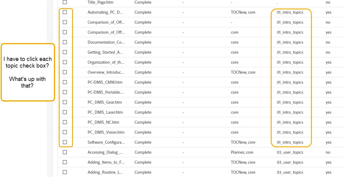

Tackling the multi select only, I found that clicking the first in a group and then holding down shift and selecting the last selected all in between. Also if you release shift and click another the first group is not lost and you can create another group.

Now I feel stupid... Ah well, what else is new? 🙂
I was trying to click on the row with Shift + Click, not on the check box iteself. Thanks for straightening me out. In that case, this IS probably the best way forward for what I need. Thank you Peter!

Well... after trying it, I have to amend my response somewhat. It would be the best way forward if the window itself didn't have it's own mind-numbing challenges.

2. CBT applied on a book in TOC is not applied to topics inside it.
         This is not so. When a CBT is applied on a book in TOC and you exclude that book from output then topics inside it are also excluded. One of the excluded topic might be coming in output if that topic is set as default topic. Please check this again and let us know what is happening at your end.
This is not so. When a CBT is applied on a book in TOC and you exclude that book from output then topics inside it are also excluded. One of the excluded topic might be coming in output if that topic is set as default topic. Please check this again and let us know what is happening at your end. - Interesting. That's good to know. But if I apply a CBT to a book topic, I would expect entries within that book to take on the same CBT, but they clearly aren't doing that. And that's where I gave up. Even if it does work, I'd still have to click on each main TOC book and set the comment CBT. I'm looking for an easy way to exclude multiple folders of content and then bring them back in a little at a time to find the problem.

Regarding your suggestion to use the Topic List report, pray tell, how does one multi-select more than one topic at a time? Note that I have 2000+ topics in this project.
I've sorted by folder. Suppose I want to exclude all the topics from my 01_intro_topics folder. I see a check box next to each topic. Yes, I can select those one at a time. But again, I want to exclude nearly ALL of my topics and bring them back in folder by folder. Surely, you don't expect me to click 2000 times to exclude a range of 2000 topics do you? *shudder*.
I tried it and there is no way to do a Shift + Click to select a range of topics in the topic list like you can do in most modern apps. The only way is to click click click click those check boxes 2000+ times. Yikes...
If that's the only way, I don't think that the Topics List report is the way to go. In RH 2017 you can multi-select topics, but for some reason that didn't make the cut into RH 2019 new UI.
(Update - Peter set me straight. You can do this but you have to click on a check box, press Shift and then click on the final check box in the range. I was trying to click on a row and not the check box, and that obviously doesn't work).
