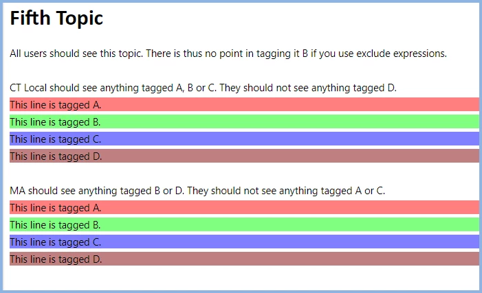

I created this topic.

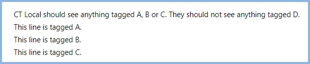

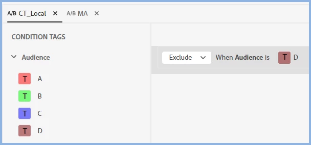

Local Expression has to include A, B and C so it has to exclude D.
With that expression I see this. The line tagged D is not there. Correct result.

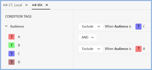

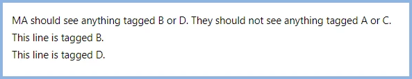

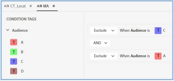

MA Expression has to include B and D so it has to exclude A and C.
With that expression I see this. The lines tagged A and C are not there. Correct result.
