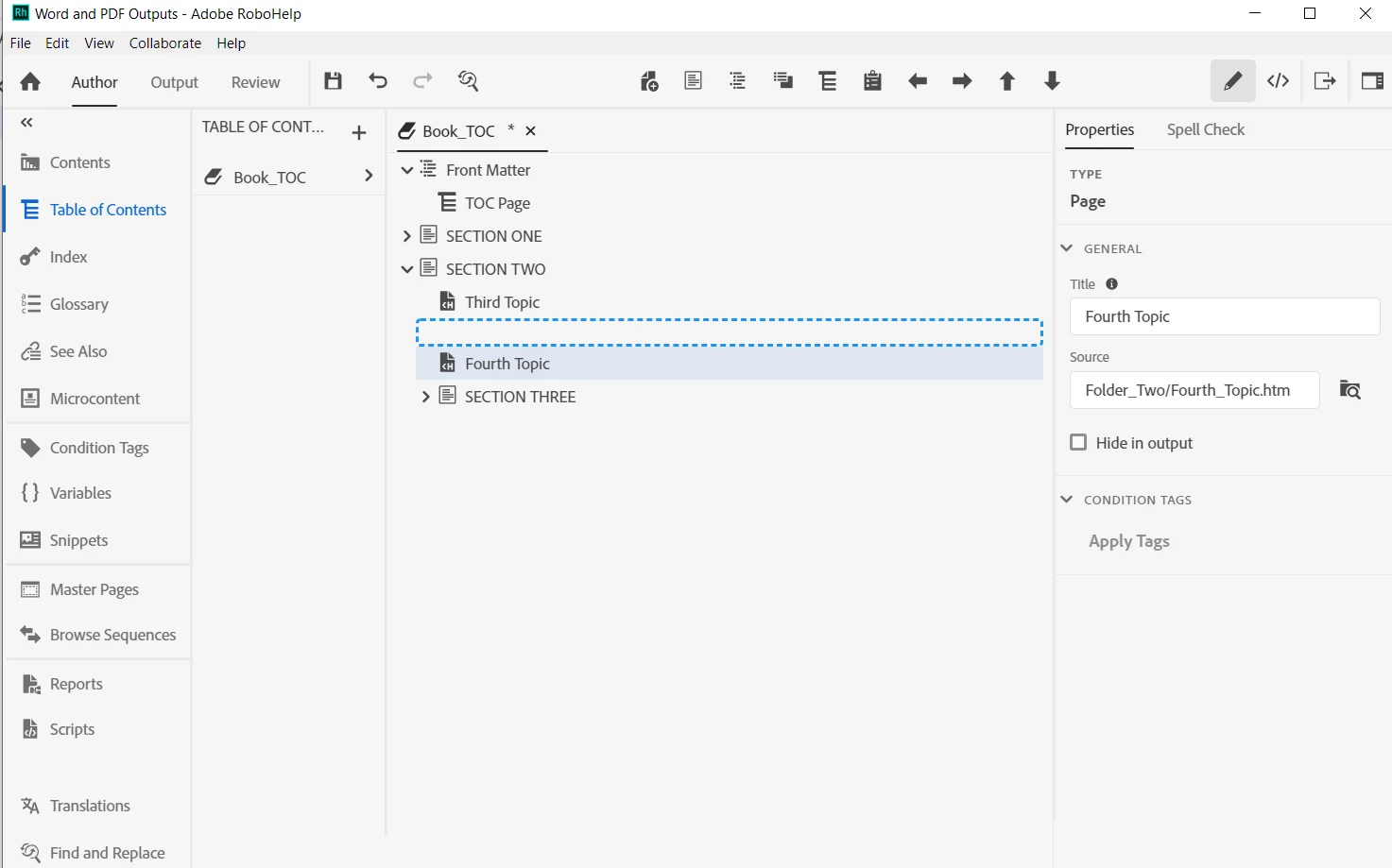

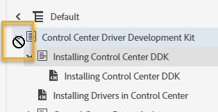

I upgraded to RH 2020.3.32 and now, in either new or existing projects that have been upgraded, I can no longer reorder topics in a TOC using drag and drop:
Has something changed? Has anyone else noticed this?

    Peter Grainge
    Dec 15, 2020 9:19 AM UTC
    I can't tell from the screenshots whether you are editing in the TOC panel or the authoring area. The former has been blocked for technical reasons. Open the TOC in the authoring area and you should be OK.

    AdvancedHelp
    Dec 15, 2020 9:01 AM UTC
    Hi Peter,
    I can move them using the arrow menu.
    I can't drag them in from the Topic List, which I could yesterday.
    A new TOC doesn't have the functionality.
    New projects are also affected for me (I happened to have one open!)
    Nicola

    Dec 14, 2020 3:01 PM UTC
    Not a problem I have encountered or seen reported. There should be some dotted lines as you drag and drop, maybe not showing in a screenshot.
    It shouldn't be necessary but have you rebooted since updating?
