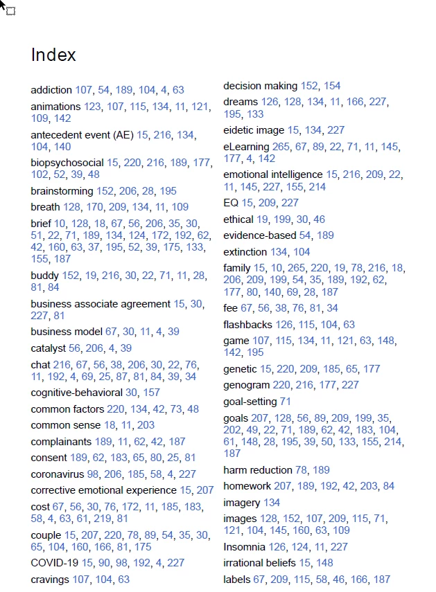

Have been moving chapters and topics around to better organize a book. When I checked a published PDF, the index pages are now out of order (for example, for an index term: 256, 25,190, 20, 22, 26, 80, 15,...).
Will I need to create a new index from scratch or is there a way to rebuild the existing index so that page numbers for each index term are reorganized and in ascending order?

    I upgraded this from RH 2019, and the page numbers were correct in it. While I moved a few topics, the bigger change was setting up chapters to place topics in, to better organize the readers viewing, facilitate reader navigation. The RH 2019 index worked flawlessly, but from looking at a project PDF published from RH 2019, it used topic names not page numbers. That would be an OK index option for publishing in RH 2020 (topic names where each index term appears), but does not seem to be the default in RH 2020. RH 2020 autogenerates the index with page numbers (out of ascending order for page numbers), not topic names. No matter how I add keywords to an index term in RH 2020, the UI sorts them alphabetically, so I end up with topic corresponding page numbers sorted by their topic's alphabetical order rather than sorted by ascending page numbers.
    For example, I tried to move the keyword topic names in an entry. They move but then snap back to their alphabetical pre-moved position. So, if I moved them and they stayed moved, that would work.
    Not sure given the underlying RH script/code how to fix this, because it over-rides any attempted solutions I have tried. For example, it would also work if there was a tick box option to display index keyword topic locations by topic name instead of page number, or, of course, if the index had an option to display the term's keywords by their topic's ascending page order.
    Looking at just Addiction are you saying that originally the page numbers were correct, then you moved them around in RoboHelp's TOC and generated again, now you get what you have shown?
    If not, please clarify?

    At first I thought that this out-of-order issue may be caused by the out-of-order items being part of front- or back-matter. But further investigation shows that entries in the main body of the chapters and topics are also out-of-order. What it does correspond to is topic name alphabetical order. So, I tried to change this order in an index entry, but, even when moved up or down, it reverts to alphabetical even though these are not ascending by page number. Moving doesn't stay moved into correct ascending (by page number) order.
    screenshot of index entry COVID-19 (see also previous screenshot in posting above).
    Preface is page 4 and so in ascending page order should appear first.
    If this can be reproduced, verified, it would need to be fixed so that the index is built using ascending page numbers (or atleast an option for this). What do you think?

    Screenshot for Index from published PDF attached. (If you need a different screenshot, let me know.)
