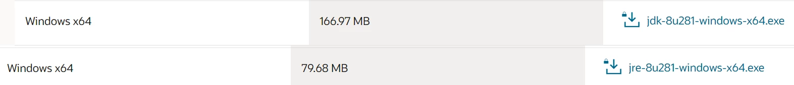

    Feb 15, 2021 1:30 PM UTC
    Thanks @Peter Grainge . I did install the 64 bit version of JAVA.
    The following versions:
    from https://www.oracle.com/in/java/technologies/javase/javase-jdk8-downloads.html
    and
    https://www.oracle.com/in/java/technologies/javase-jre8-downloads.html

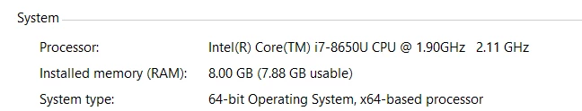

    My system configuration:
    Also referred PDF Output (grainge.org)
    Radhika

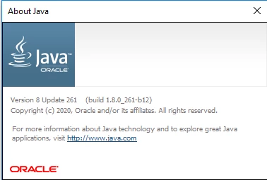

    Jul 17, 2020 8:05 AM UTC
    Hi Peter. Thank you for your response.
    I am running the latest version of Java 8 - which is higher than the version specified in the topic:
    I will get in touch with technical support.
