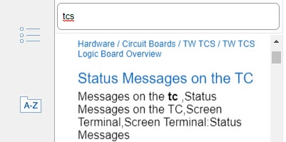

Adobe Employee
Jan 14, 2021 7:45 AM UTC
This is happenning due to a preprocessing step(stemming) which is applied on topics. In this step we convert all the words to it's root word before indexing them. For example, Development, Developing and Develop  all have same root word, which is Develop, so instead of indexing all the three words separately, we index only one word. So when you search using any of the above words, you will get results for all three words.
Same thing is happening with tc and tcs where both are converted to tc. So when you search using any of these two words, you always get the results for both words. Currently there is no work around for this issue.
In future we will evaluate if certain words can be excluded from this preprocessing steps which can be used in scenarios like this.
For other issue which you mentioned for tcs being broken into tc and s, please try this with update 3 and let us know if you still see this issue.

Jan 13, 2021 3:34 AM UTC
Circling back on this. I've since upgraded to 2020.3 and it's still an issue - even with "Auto correct search query" and "Enable substring search" both disabled. Here's an example - note how "tc" is bold in the search preview/context of the result (btw, this topic doesn't have an instance of "tcs" in it - anywhere), even though "tcs" was the search term.
