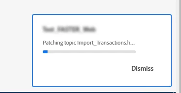

RH 2022: Responsive help is not getting generated
In a project, there are more than 10 book with sub-books and topics (700+).
Observations:
  • Ouput is getting generated for some specific books of TOC.
  • But, the entire project with the complete TOC, the responsive output is not getting generated. Can see the output generation process, but after some time, the ouput process gets stucked with a specifc topic (somtimes differenct topic names) and not moving ahead.
  • Removing the specific topics from the TOC is not a proper solution. RH is not showing any logs or error messages for this issue.
RH version 2022.4.179
Please help

    May 19, 2025 5:31 AM UTC
    Patching topic xyz.htm..
