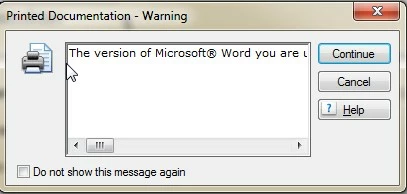

RH 9 - Connect to Word
I'm trying to generate Printed Documentation.  When I do so, .docx is not listed in the "Generate Word DOC" drop list.  When I do select .Doc, I get this message "The version of Microsoft® Word you are using has some known limitations with documents that contain a large number of list items (~1500). To avoid this problem, please download the latest Office 2000 service release (SR-2 or later). For more details, please see the online Help.".
I'm using Word 2010 (64-bit) on a Windows 7 (64-bit).
How can I fix this?

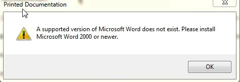

I am facing a similar issue with MS Office 2013. I am using Adobe Robohelp 9 and MS Office 2013 (32-bit).
  • In Single-Source Layout pod, after a click on Printed Documentation, the below message appears:
In Single-Source Layout pod, if we right-click on Printed Documentation, click Properties, and then click Save and Generate. The message below appears:
Content inside the box: The version of Microsoft® Word you are using has some known limitations with documents that contain a large number of list items (~1500). To avoid this problem, please download the latest Office 2000 service release (SR-2 or later). For more details, please see the online Help.
Please suggest the solution.
Thanks
RoboColum_n_
Dec 10, 2013 10:39 AM UTC
Even the latest version of RoboHelp does not support Word 2013. You'll have to downgrade your Word version to one supported by RH9 (e.g. Word 2010).
