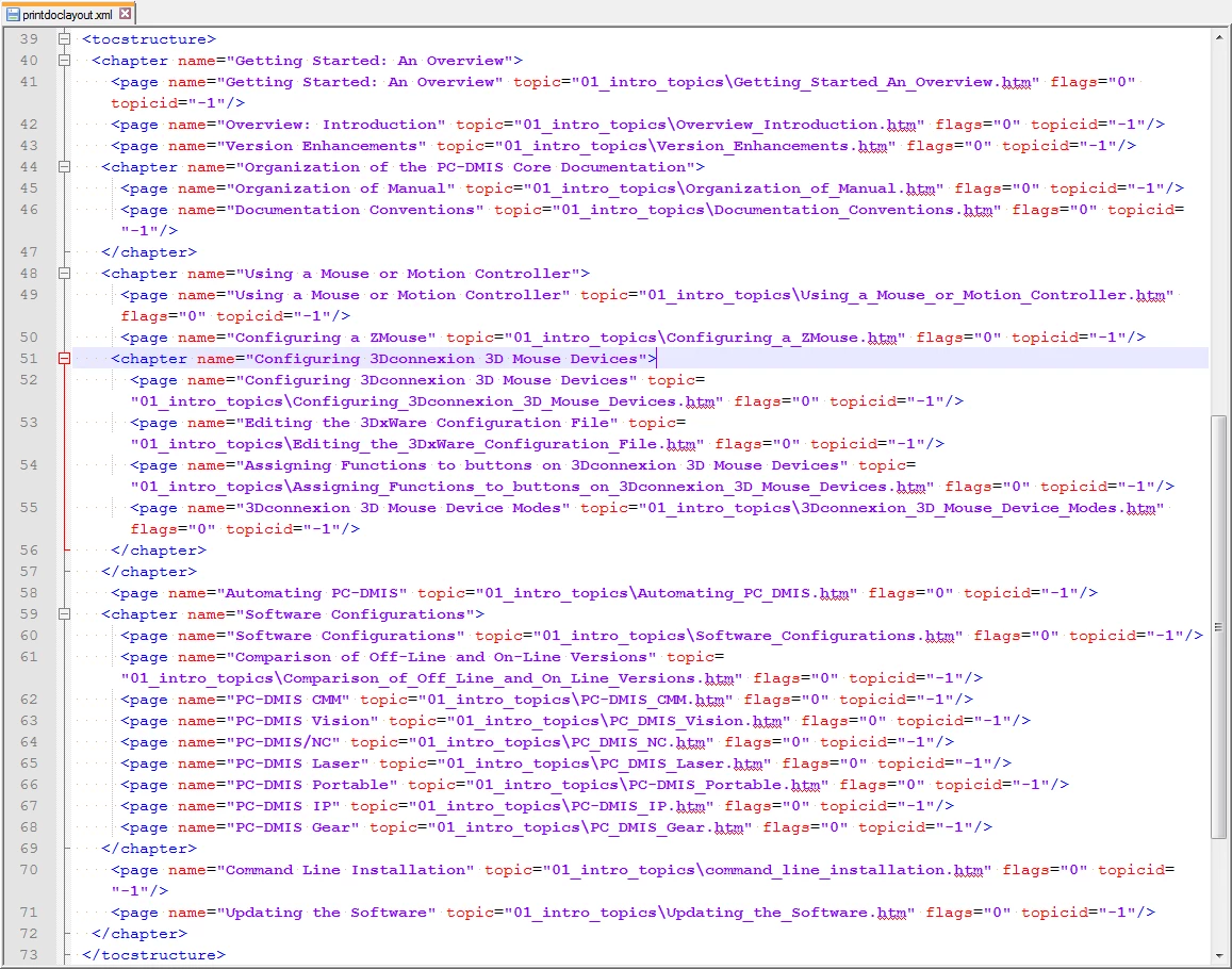

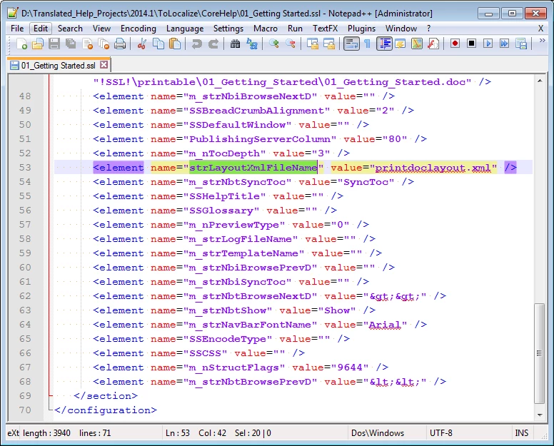

About SSL and printdoclayout.xml Files: I've looked into the SSL files in a text editor, and the SSL files for printed outputs do not specify themselves what gets sent to the .doc or .pdf. Instead, when you create the SSL, RH also creates a unique xml file with this name printdoclayout(n).xml, where n is a number that increments for each additional printable SSL you have and the SSL contains a reference to use that XML. The printdoclayout.xml actually contains the chapter structure that gets sent to the printable output:
Within the <tocstructure> element, it contains the hierarchy of what to export. (Note that even though it has <chapter> and <page> elements, those are misnomers since they're really just topics references with <chapter> for a book-style entry that contains a subtopics. The important thing is that in this example, the xml matches what I have in the Chapter Layout list of the Print Document Content dialog box shown above:

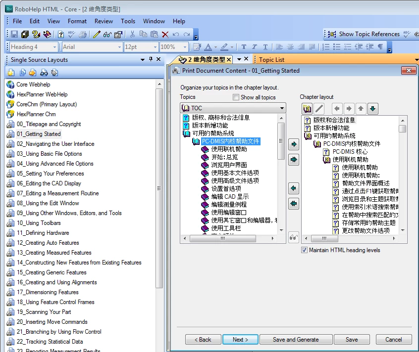

The Problem: Now we're getting the localized projects backs, but when we try to generate the printable outputs from a localized RH project, RH no longer respects what I originally defined in the 38 SSLs/xmls. Instead of trying to output a single chapter per SSL, it's trying to output ALL chapters in each SSL. For example, notice what happens when I open up the same layout in the localized Chinese. (Notice the blue highlight in the left side of the Print Document Content dialog box, showing that ALL the chapters are now somehow selected.)

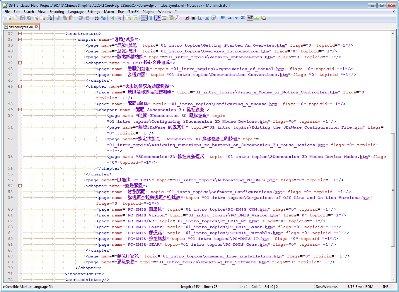

I don't understand why merely opening up the SSL causes it to select ALL the topics for the generation, especially when the underlying (localized) .xml file still shows the correct chapter output as shown here:

I think I found the issue. The printdoclayout xml files that we got them back from localization were formatted slightly differently from the original English
The English version had line breaks, like this for its first three lines:
<?xml version="1.0"?>
<!--Printed Documentation Layout-->
<printdoclayout version="2">
The Localized version did not. It was all on one line, like this (you'll notice there's the extra attributes encoding= attribute too:
<?xml version="1.0"encoding ="UTF-8"?><!--Printed Documentation Layout--><printdoclayout version="2">
When I copied and pasted the first three lines from the English on top of this first line in the localized .xml files, it worked! All is good now. I just need to work with our localization department to make sure this doesn't get that formatting again.

Although, I wonder if modifying the underlying printdoclayout.xml file causes RH to want to reset the printable layout file (SSL). I haven't tested that theory yet.
I also wonder if is there a file somewhere that affects how the SSL is generated? So I started looking through the different file types in my project folder and looking at them in Notepad++. The .pss file does contain references to the SSLs. For example, there's this:
