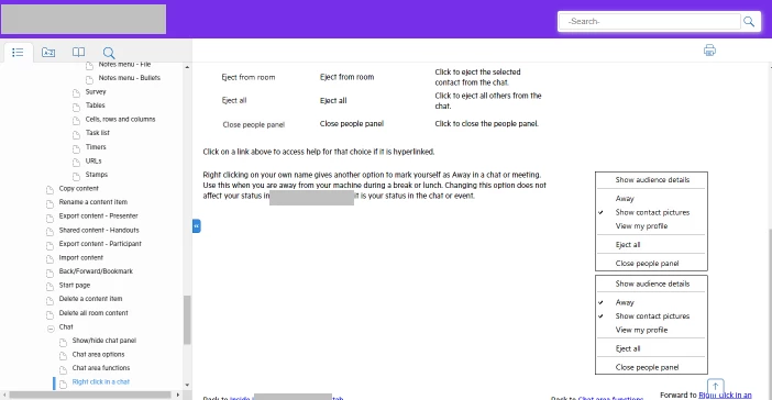

I've created a new responsive layout, what I think you meant by a new skin in your last message. From there, I changed one thing at a time and verified each output before moving to the next. Each verification was expanding and contracting the window, minimizing/maximizing the TOC and again expanding and contracting the window to make sure the scroll bar did not disappear or freeze as with the last pictures I'd shown you. With the last change, I increased the bottom margin in layout.css at body.media-desktop div.topic, changed from 0 to 10px as back/forward nav links were being cut off, i.e., I could see the tops of the text, cursor changed to select hand but it wasn't the entire text being seen. This is the first of the results:

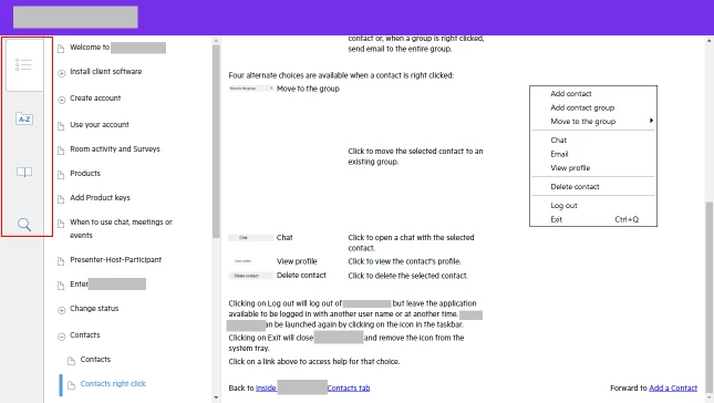

In this one, the TOC, indes and glossary tabs are on the side. One small pull to the right further and I get this:

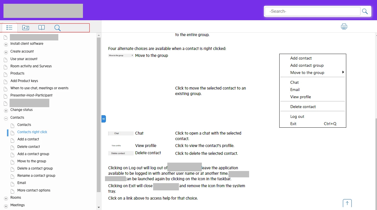

Note that now the TOC, index and glossary tabs are now at the top. In addition, the visual presentation of the scroll bar is different, it's now significantly thinner than the first example.
Also note that the last line with back/forward text is completely gone. The disappearing back/forward line is not present in all pages but a significant number in my project. There is no consistency as to where the lowest line shows up when scrolled all the way to the bottom, sometimes it appears just above the bottom on the window, sometimes slightly above.  Here's another example where you can see the different text displays on the last line.
