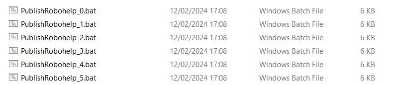

In our project, we have 12 Frameless output presets that we generate on a daily basis with batch scripts and upload to a file server.
As has been brought up before, the commandline tool tends to get stuck (rh-render-process-gone) if you generate multiple presets. Our dubious 'workaround' for this is to have 12 consecutive batch scripts, one for each output preset (which is a bootleg method to sort of force the RH application to restart each time). Each batch script gets run at a specific time with Windows task scheduler.

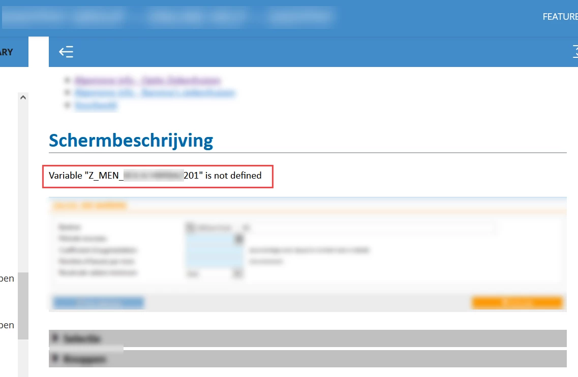

The output generation works fine save for one big issue. For reasons I cannot pinpoint, the variables sometimes fail to get published:
There does not seem to be a consistent trend I can discover.
This missing variable problem usually happens to about half of the published outputs, but it seems to vary each time. I've tried to add a log parameter to the command but that causes rh-render-process-gone almost immediately.
