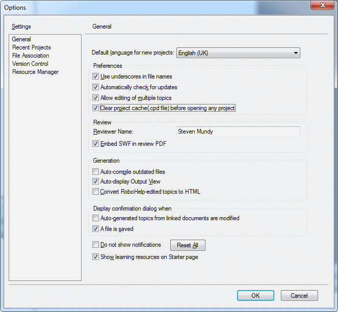

    4. Now set cpd to Clear project cache (cpd) file before opening any project using the following screen:
    1. Before closing project links intact and folders present.
    2. Next re-opened project and then found files and folders missing and broken links.
    The problems seems to be then that doing what I've been advised to do in the past i.e clear cpd breaks links and causes folders to be missing.
    Something that controls the makeup of theporject other than cpd is not right.
    Please can anyone offer any suggestions? A specific file perhaps?
