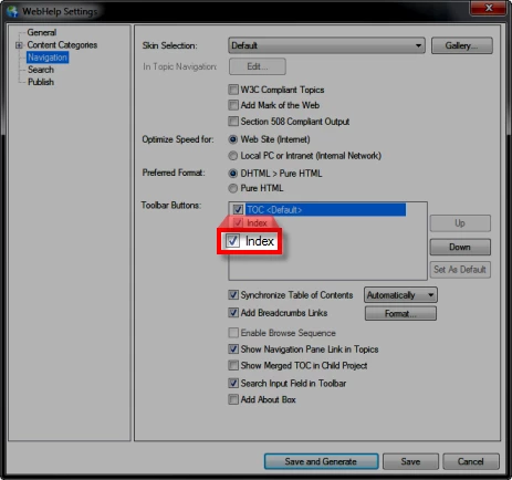

RH10 - how do I change the toolbar button choices in WebHelp Settings - Navigation?
I'm using RH10 to update several WebHelp projects. In WebHelp Settings - Navigation - Toolbar Buttons for one project, I have TOC (default), Glossary, and Search. For a different project, I have TOC (default), Index, and Search.  How do I add an Index selection to the project that only offers TOC, Glossary, and Search?

Hi there
Look at the properties of the Single Source Layout. Specifically, the area on the left where it says "Navigation". Click that.
Then look at the large white box on the right side. You should see an entry labeled "Index". Ensure there is a check mark there. If not, that's the issue. If there *IS* a check mark and the index still isn't appearing, you may need to specifically nominate an index file inside the Content Categories area.
