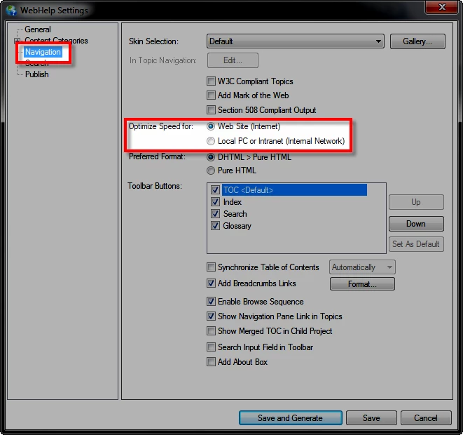

First off, it always helps to check the basics. Are you certain you are looking at the correct location?
Assuming you are, look at the properties for the single source layout. Specifically, the Navigation section on the left side and the "Optimize Speed for" option on the right side.
Click the image below for a larger and clearer view
As far as I'm aware, this is the specific setting that determines whether your navigational elements are broken into smaller chunks.
Lastly, I'm a bit confused. To my knowledge, only the navigational elements (TOC, Index, Glossary and Search) are affected and XML data created for these. I'm rather surprised to hear that your development team is somehow using the XML files created for these in order to establish context sensitive help.
Cheers... Rick

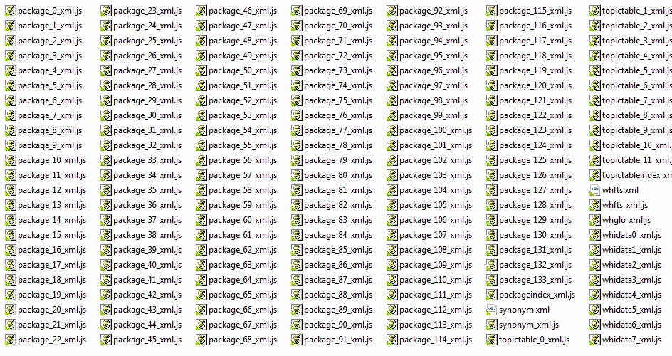

I'm not sure what practice established using the XML files, but I know that they could not connect the help topics if there was not an index entry for the topic.
I have checked all of these settings, and they do not change the output.
I should clarify, though, that there are files being generated, just not the ones that we would prefer.  See the screenshot below.
Captiv8r
Oct 1, 2013 3:33 PM UTC
Ahhh forgot about that. Yep, the dev team renamed them all from .XML to the .JS. Not sure why.
You might consider submitting a bug report as this affects you.
