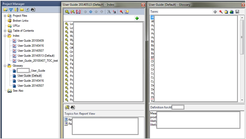

I am having such a tough time with RoboHelp. My current issue is the glossary and index not appearing in the generated output. They used to. However, yesterday I thought I should go in and clean out all the junk in my project, i.e. I had about 5 glossaries and 5 indexes because I was testing things out. I made sure I didn't delete the populated glossary and index, but by the end of the day, they were both gone. So, I located these again from a backup and imported them back into my current project. Everything is there...all my terms and definitions, the index and the links...blah blah. NOTE: Everything is there, but I was required to block it out due to privacy issues.
However, this is how it now displays when I generate:  Why won't this populate?

Rick,
I'm using IE 10, Version 10. And everything was working fine until I started deleting the extra glossaries and indexes I had in my project. I have been generating locally, then when I get to a point where I'm satisfied with my changes, I generate to the server. I wasn't having a problem with this until I deleted those files. Although I have imported the glossary and index back into the project, still nothing. Now, even if I pull up an older version of this same project, the glossary and index are now gone from that too. I'm assuming that everything must be linked, but I can't figure out what I'm missing. Generating to Chrome has the same issues. I had one of my developers look at it yesterday, and he thinks there is some file missing somewhere that RH11 needs to generate the glossary and index. What file would I be missing? The .glo and the HHK files are in the project. I really need to upload this for the client, so any help you can give me is much appreciated.
I read on one of the forums that I should have this ticked in the Optimization Settings for Responsive HTML:  "Limit the scope of project styles only to topic contents". I did that and it caused all kinds of other issues.
On Monday I updated to RH 11.0.1 - would there be an issue with that? Is it a dll issue?
