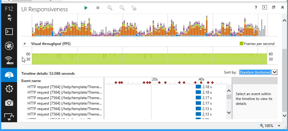

This issue needs some debugging. Can you try the following? Open IE and
press F12. This will open the developer console. From there, select the
timing tab. With this tab open, open the output in IE. The browser
should now show you how much time all the elements are taking to load.
Can you post the results of that?

Before I post some of the load results, please let me know if I am looking at the correct area of the dev console. I have a UI Responsiveness tab in my console. Is this what you are referring to?

That's the one. Try the following: go to an unrelated page and start the
responsiveness profiling. Type the URL of your help and let it run. When
the page is loaded, stop the profiling and look at the results.
You can sort by duration. That will show the slowest processes first. Do
you see one or multiple 'HTTP request ' as the ones with longest duration?
This issue sounds to start like a bandwith issue: There is too much data
for the device speed. That you don't see any delay supports this, as
your browser caches used resources. So any second or third visit will be
much faster. If you remove your internet history and local cache, you
should get the same delay again.
