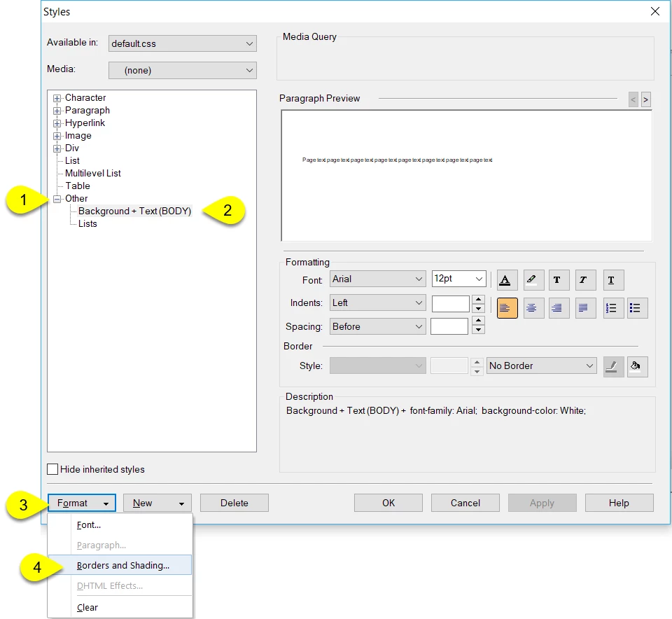

In addition to Amber's excellent information, you can also accomplish it by using RoboHelp to manipulate the CSS.
First, you will want to create an image that will be used. Then save it somewhere on your hard drive.
Then open the RoboHelp CSS editor. I just find the CSS in the Project Manager and double-click it.
Then head to the following location:
Other > Background+Text(BODY) > Format > Borders and Shading...

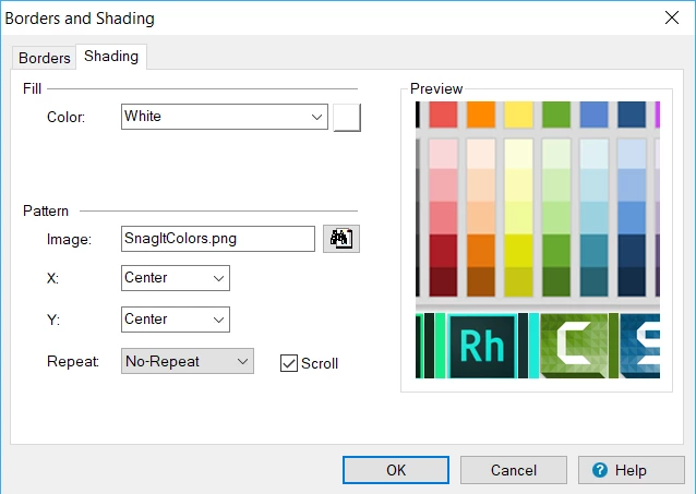

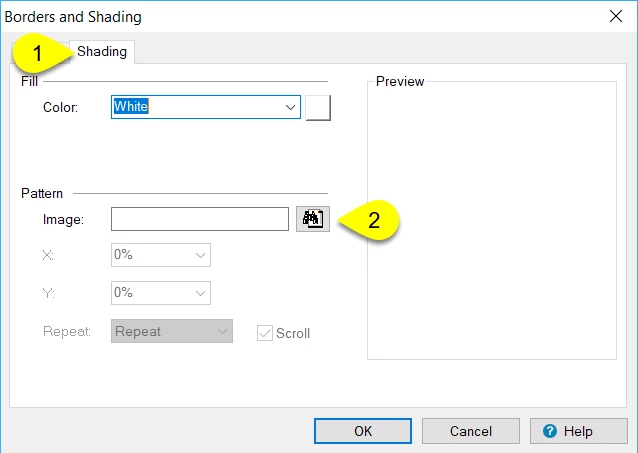

Then from the dialog that ensues:
Shading tab then the spyglasses icon
Browse to and choose the image for the watermark.
Then configure the X and Y values (likely to Center) and the Repeat option to "No-Repeat".
Note that I just grabbed the first image I could find here. So pay no attention to that. I simply needed to present the dialog as an example.
