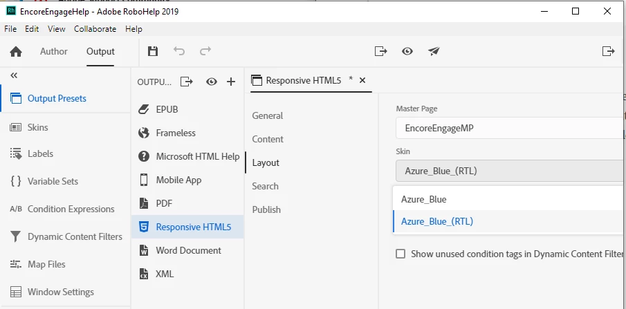

May 12, 2020 6:05 PM UTC
See your screenshot, Skins are just below Output Presets. Click + and select your preferred skin. If you want Azure Blue RTL again, give it a slightly different name.
GLNT1Author
May 12, 2020 5:29 PM UTC
What do you mean by create a new skin?  I can only select skins in the drop-down. I assume that I can just copy/rename the skin in the skin folder.  (Where is the skin folder?)
