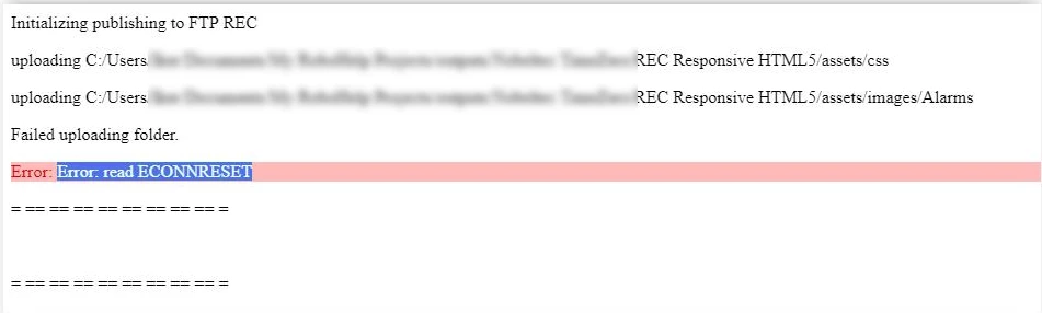

RH2019 HTML5 publishing failed with ECONNRESET ....
When Initalizing the publishing to ftp it failed uploading a picture folder and I obtain the following error : Error read ECONNRESET (failed on a specific picture's folder)
 the previous ftp publication was done without any problem!
Is somebody has an idea about this trouble. Note that i work with the devOps source control.

    I usually try rebooting to make sure no other program has the files open (Windows Explorer, Outlook and Acrobat are all bad for that). Antivirus scanning can also hold files open, so that would be something to check.

    Thanks for you ranswer which is right, i have done the latest upgrade of Rh2019 and after a all reboot the publishing was successfull !
