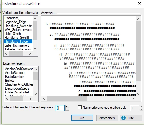

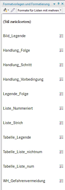

I think its about cerating a multi level list.
In RH2017/2019 Classic there is/was a own menu to create such a list:
In the top bar:
As context menu
And in the styles pod:
Now there is only a "simple" list feature and no way to create such a list.
By the way we use multi level lists intensively. Only in this list type you can add a parastyle and thus add list style and para style to a paragraph with just one click. But unfortunately this does not work anymore even in the Classic version properly.

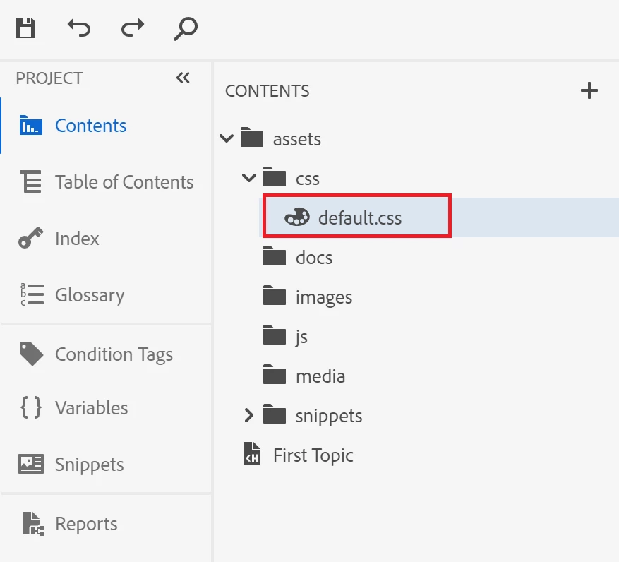

This can be found in RoboHelp 2019 here:
  1. Open your project.
  2. Go to "Contents".

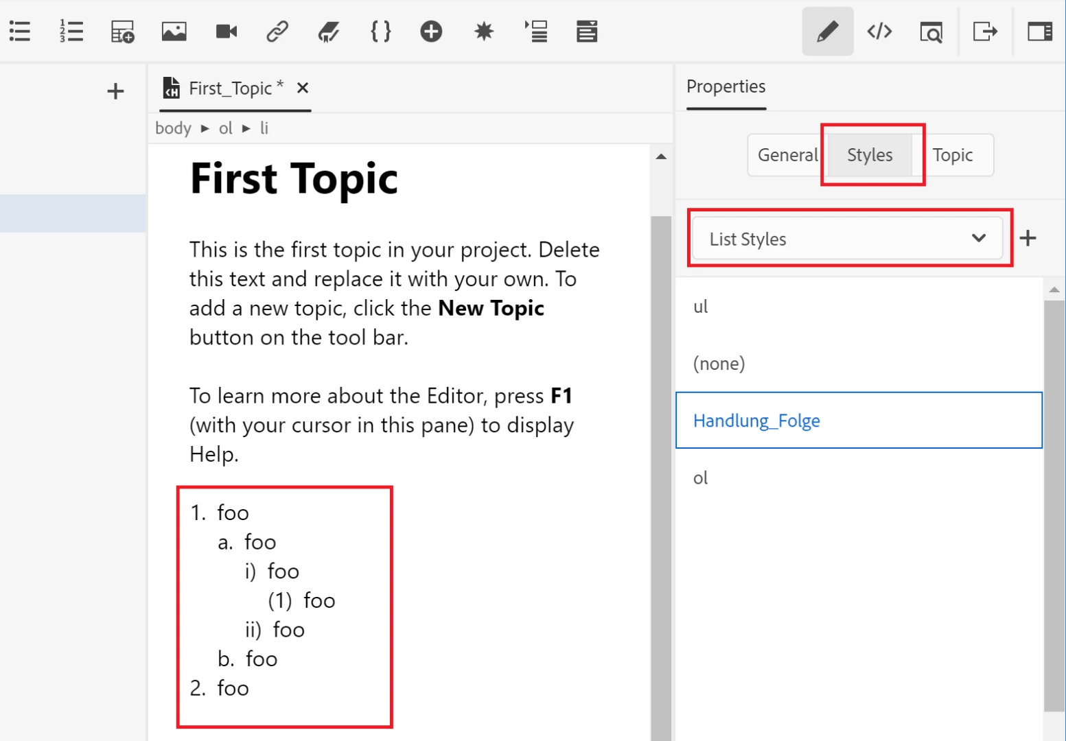

  3. In "Contents" open the "assets\css" folder, and double-click your CSS file to open it (here: "default.css"):
  4. Now the visual CSS designer opens up. Select an existing style in the styles catalog in "List Styles" to edit it:
    Or duplicate an existing style with the button, or create a completely new list style with the button:
  5. You can now customize the numbering completely.
  6. When done, you can open a topic and start with creating a simple list. You might want to select the "ol" tag in the breadcrumb navigation and then select your style "Handlung_Folge":
Now you can simply use the "Tab" key and "Shift+Tab" to push a list item up and down the list levels. The numbering changes automatically depending on the list level and according to your style specification.
