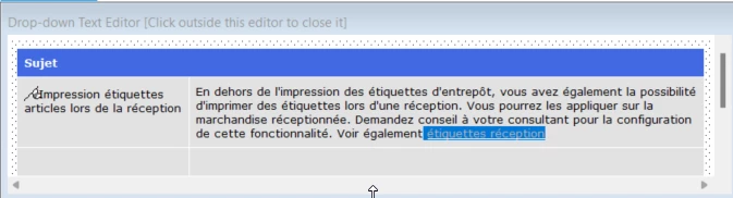

RH2019links created with dropdown text or to external topics do not have the color determined by css
in other sisterprojects the font color is blue. For this project it is white. I cannot change it. tried manually, no luck. checked the css, it is determined to be blue.
Result is as well in the RH gui as in the chm with wite fonts
I cannot attach the source, even renamed. the smartsystem detects a renamed zipfile 🙂
thx for the help
Olivier
