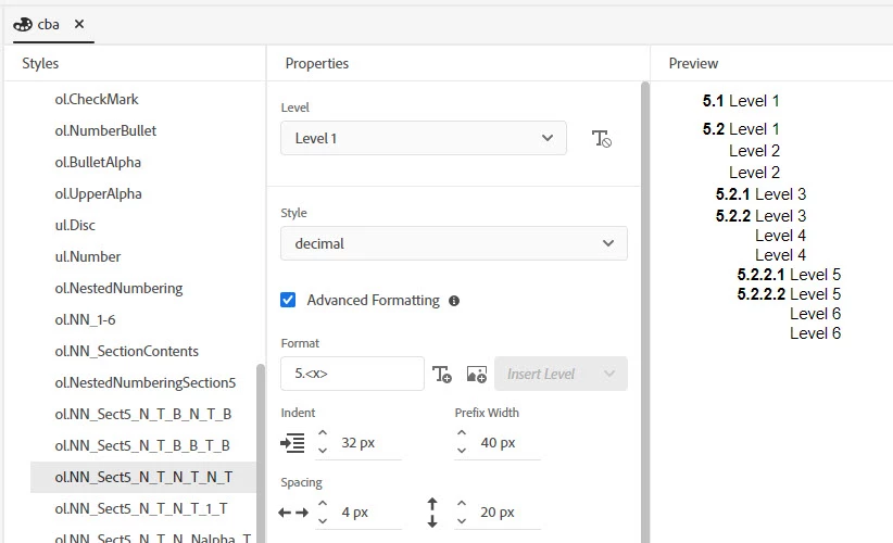

1st ISSUE: Today, I needed to create a new nested numbering scheme.  I duplicated the ol in my css to start manipulating the levels.  What I have found is this:
  • the style when changed to 'decimal' will revert back to 'none' after I hit tab
  • the numbering I try to begin with (example: 5.<x>), does not stay in the 'Format' box and will cause the <x> to become inactive.
  • the <x> will remain but you cannot edit it

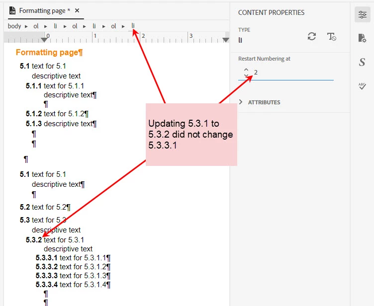

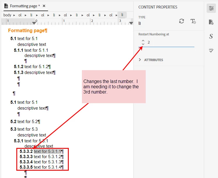

2nd ISSUE: As long as I do not edit my existing nested numbering styles, they continue to work properly until I go beyond Level 4. The issues begin with level 5.
At Level 5, my numbering should appear as 5.2.1.1 (as shown in this image) but it appears as 5.2.2.1 which is incorrect.

    As far as your wrong numbering is concerned, you have set that up incorrectly. Where you see <1><1> that should be showing <1><2>. I think you selected the wrong level to insert.

    Oct 12, 2021 12:30 PM UTC
    Maybe go into the topic code to remove any restart numbering?

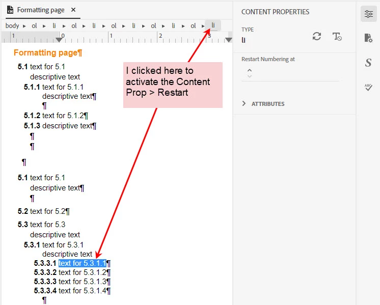

    No suggestions at the moment as I have just created a new project with a new list and it is not working as I expected. I have contacted Adobe and will revert when I can.
    On the second issue, try Restart Numbering. Click in the list where it is wrong and you should see it top right in Content Properties. Not sure if that will work here but it's the only thing I can think of right now.

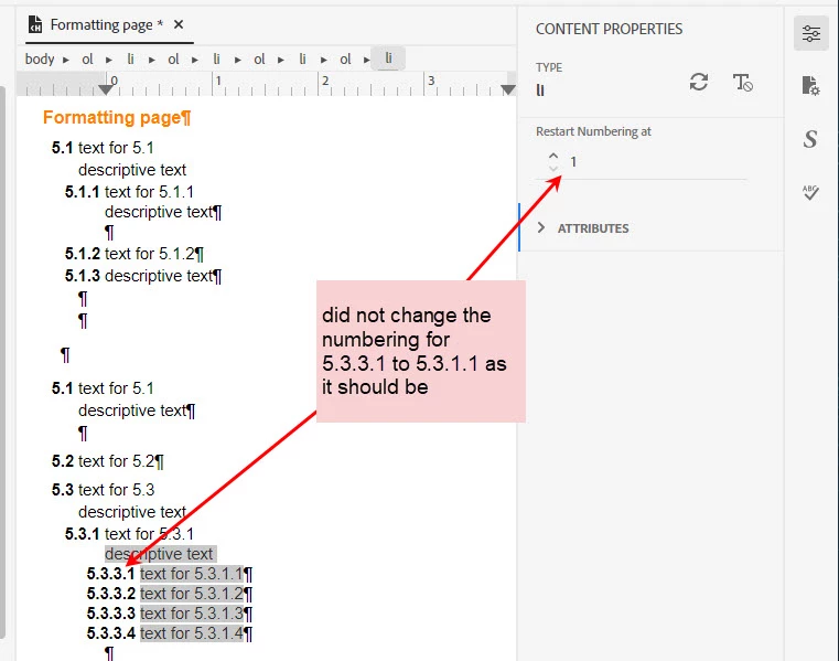

    Oct 12, 2021 12:00 PM UTC
    @Peter Grainge - Thank you for confirming the issue I was seeing with List Styles.  If you place a bug ticket, please let me know the number and I will vote on it.
    As far as Restart Numbering, I tried changing the numbering at different levels of my listing with no changes.
    What I did find is that once you place a number in the “Content Properties > Restart Numbering at”, you cannot remove it.  I don’t remember if the previous versions was like this but it is a bit inconvenient if you make a mistake, save, and need to change it.  You have to set the list style to none and start over.

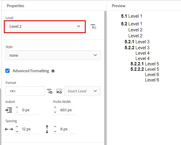

    My steps:
    My list style looks like this due to needing a line of text after a numbered line.
    Levels 2, 4, & 6 are set to 'none' to allow me to type descriptive text.
