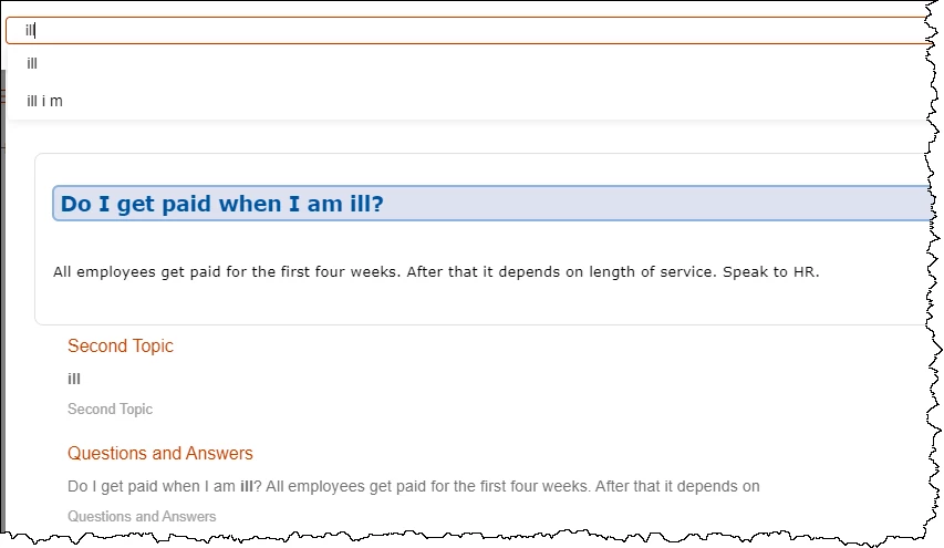

This is what I am getting with the Intent "Do I get paid when I am ill"
If I search on the full intent, I get only that in the promoted result. If I search on "ill" I get the promoted result first, then I get any topic with "ill" in it. That is how it is intended to work. See RH2020 Microcontent (grainge.org)
Microcontent alone simply promotes results as shown. Maybe you are looking for a Chatbot?
