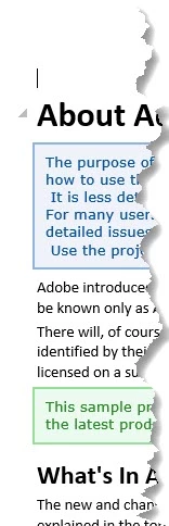

    Jul 23, 2020 11:10 AM UTC
    Hi Peter
    Maybe the image below must give more clarity to the issue. Generated the output without Master Page and Word template.
    In the image, there is an extra space above the About Adobe RoboHelp title. It is an H1 heading. This issue is there throughout the document, at every instance of an H1 heading.

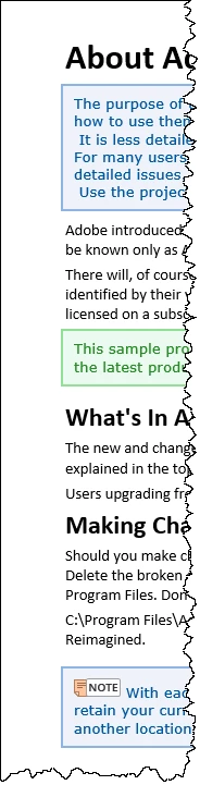

    However, I then got this which doesn't have the extra space problem but the heading styles are wrong. The project has a Print General master page which should give the appearance below. I had not selected that master page so the styles should be the same as online. Clearly they are not.
    I have to go out shortly for most of the day but I will look later. Let me know whether you are seeing the online styles in Word as well with no master page set.

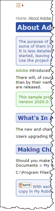

    Jul 23, 2020 7:40 AM UTC
    I don't know why you are seeing the extra space and missing icons. I just generated this and viewed it in Chrome.
    No extra space and image shows. There is no setting for this and I have tested in the other main browsers.
    Have you viewed the same output on more than one machine?
