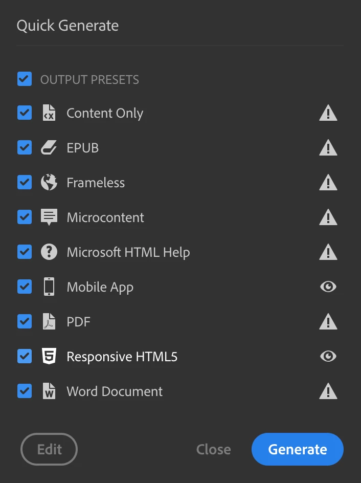

RH2020 has multiple output errors ! cannont generate output * see screen shot

    You've mentioned PDF and Responsive HTML5 as output types you need, and that you won't be using Mobile App.
    I think concentrating on one output at a time might cut down on the variables.
    So could you untick every output type except Responsive HTML5 and confirm that it generates correctly? It looks like it does in your screenshot as it has an eye icon.
    Then untick Responsive HTML5, and tick PDF instead, and confirm it doesn't generate. Then we can look at the error the PDF output log and your settings and see if we can figure out why it isn't working. It's possible solving the issue for one output type will be the solution for most of the others.

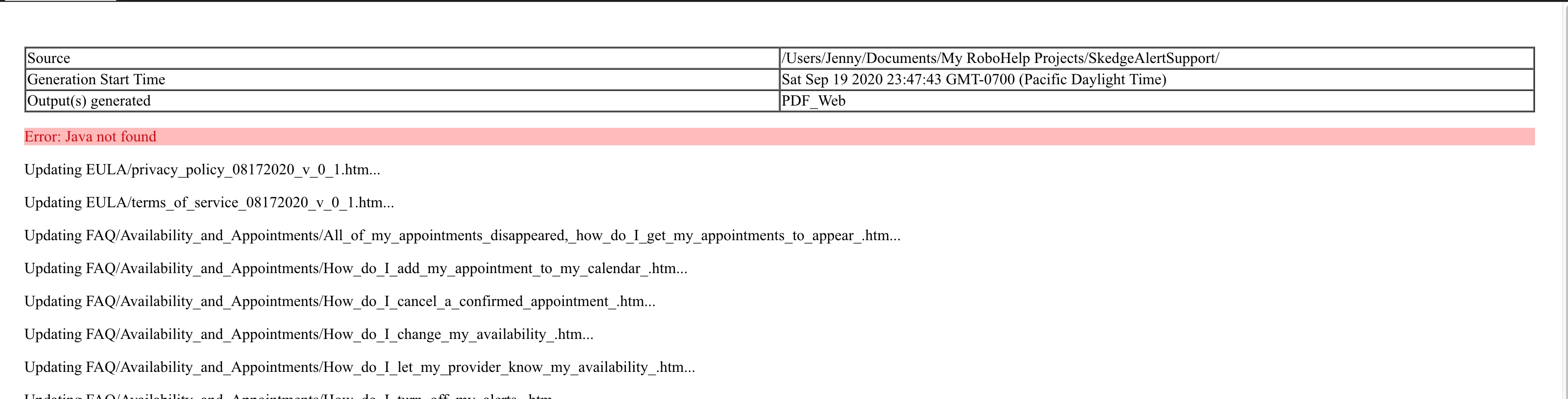

    I have seen that error continue where the wrong version of Java had been installed. Check you have the right version for your machine.

    Sep 9, 2020 6:42 AM UTC
    Are you really using 9 different outputs or do you only want Responsive HTML5 and Mobile App output?
    If you only want Responsive HTML5 and Mobile App, then those generated successfully and you can click on the eye symbol next to each to view the output (at least I assume it will work for Mobile App as I never tried that output before...). Next time you generate, only tick those two options. Make sure all the other ones are unticked. You can delete any unneeded presets from the Output tab.

    Go to the Output tab, right-click on one of the problem outputs and select View Log. Are any errors listed? What are they?

    The only errors was "Failed to Generate xxxx output".  Thank you for telling me to check the logs, I didn't really notice that option in the menu.

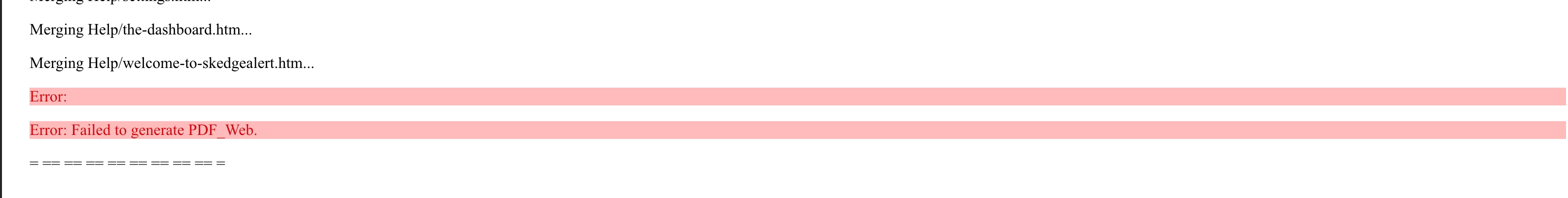

    I've attached the error log. messages at the top and bottom of the log because it's very long...
    It says "Java not found". I read that this means I need Java 8.  I installed Java I and still get this error?
    Please advise on next troubleshooting steps,
