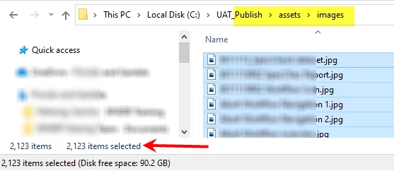

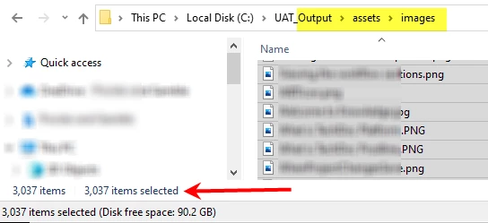

    Apr 26, 2021 3:09 PM UTC
    There are 914 more image files in my Output assets > images folder than in my Publish assets > images folder.  That is a huge difference!
    I have created RH-9079 to document the bug.

    Prior to the latest generated Output and Publish versions, I deleted all files in those folders so Rh had to build each from scratch.  I read in another community page that doing this could help.  The images still did not show up in the Published version.
    With my team, we looked at the 'Output assets > images' folder compared to 'Publish assets > images' folder and found a lot of discrepancies.   It seems the WBTicon.png (along with other images) did not generate in the 'Publish assets > images' folder.  When I copied WBTicon.png over to the folder, the image appeared on my newly launched Published pages.
    Is there a bug now in Rh2020.4.173, where the assets > images folder does not completely generate from Output to Publish?

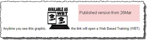

    I am using Responsive HTML5 Output preset.  The image is a .png file.  The image worked under Rh2020.3.32 when I published 26Mar.

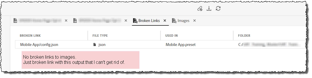

    I have checked the Broken Links report.  No issues with the links.

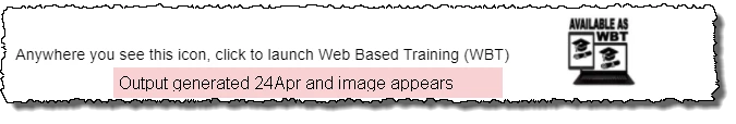

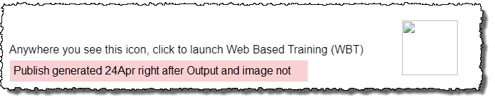

    I have checked the Images report.  The image is showing used.  The image appears on multiple topics.  In the Output the image is there.  On the Publish version it is not.
    Examples of how the image is appearing on topics when I generate an Output and immediately generate the Published version:
