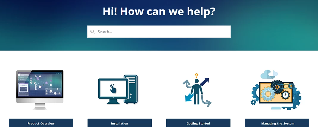

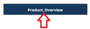

When importing Word files, spaces between words in the file name are replaced with underscores in the Topic name in RH. When I generate the output, the underscores are showing in the button labels in my frameless skin.
I do not want the underscores to show (I want spaces between the words used in the button labels).

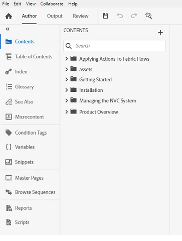

I did have to upgrade to 2020.3. After completing the upgrade, I generated my Frameless output again and unfortunately, the underscores were still present (see screen image). The underscores do not display in RH (I think I initially reported they did show in RH), but they DO display in the Frameless output.  I should also reiterate there are not underscores used in the file name of the Word files I'm importing.  I noticed that the corresponding html pages RH creates do contain underscores. I guess I am going to have to try and create it from scratch in the updated version of RH and see how that works.

You have tagged your post Classic but 2020 doesn't come with a Classic version, you are working with the new UI. I will correct that later.
It would help if you could show a bit more of the screen to see where this button is appearing.
