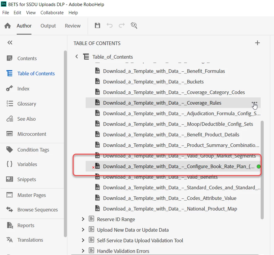

    If the link in the toc is broken, you'll need to update the toc as well, otherwise that toc entry will give an error.

    Jeff, thank you.  I was able to see through the Contents pane that my document does include the new additions. Now to see if I can republish successfully!  🙂

    Peter, thank you for your response. I did that, but now it shows a red "x" by the section that was updated, and I can't open it to ensure that my changes are present. I tried syncing again, closing and then opening RH, but it would seem there is still a step that I'm missing. Screenshot attached.
